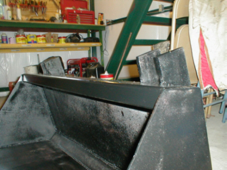

I used the new bucket most of the day today moving clay from the pond construction. It works great, at least on pre-bulldozed clay. Adding the extra 4" seemed to have almost doubled it's capacity from the original one.
I assumed there wasn't much interest in a "homemade" bucket, so I just built it and used it.

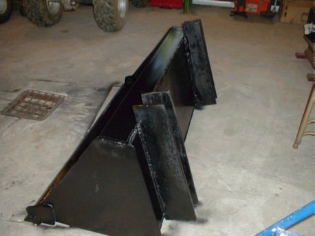

   / Built me a bucket
another pic

   / Built me a bucket
I left the 1/2" plate brackets sticking up until I decide if I should use them to pin in some forks instead of the receiver style I had before.

   / Built me a bucket #7
David, nice job. Certainly doesn't look "homebrewed". I didn't realize the original pic was the bucket you made..............chim
   / Built me a bucket
I goofed when I posted that first pic,{it is of the original small bucket} tomorrow I will get one of the new bucket on the tractor. I copied the original, but made it larger. the pics of the bucket in the shop are the new one.
