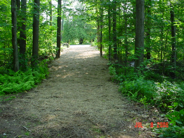

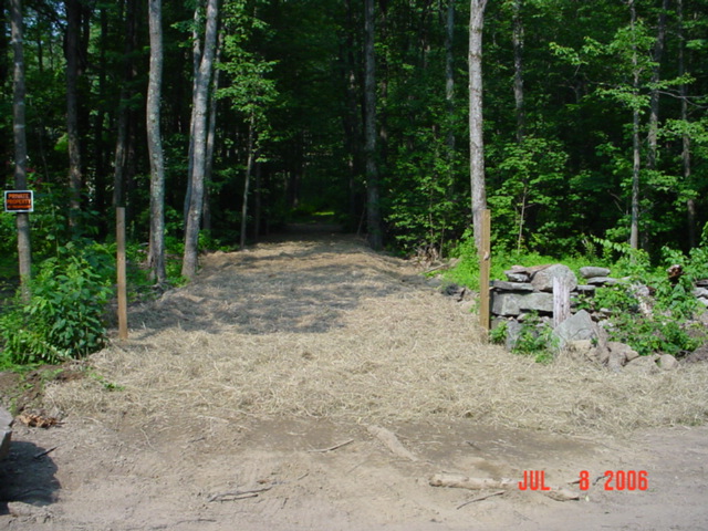

My finished road. It now has 90 yards of clean fill. It is all graded and seeded. It also passed an inspection today by the C.C. He said I did a fine job on it. I also have permission to dump rock on it once it settles a bit.

JimR, I don't understand the grading and seeding part of the road project? Could you elaborate?
   / Bulding a new access road, repairing the old one.
Gary,
This road is my only present access road to our 36 acre wood lot. The road is in wetlands territory and crosses a feeder brook for a drinking water reservoir. It has to be made so that it doesn't create silt and dirt runoff. I have the road slightly banked to the upstream side of the road. It is seeded with grass to hold the fill in place. The hay is put on to keep the dirt from washing out. Once the grass starts to grow. I can bring in a load of crushed stone to harden up the road. Almost all of the road is clay. The very top is a mixture of loam and dirt. The C.C. said to just keep an eye on it for washing out. I don't think I will have that problem. I do have a lot more hay to lay on it if it does start to wash out.
