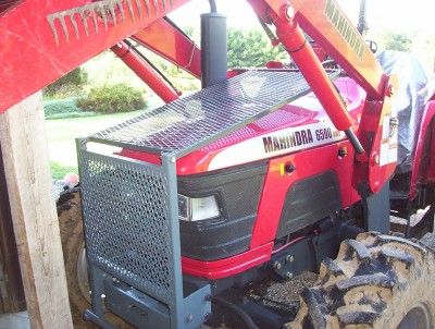

Do any of yall have or made a good bumber for a 5500 fwd, other than the factor one, the dealer put a brush guard on it when i did the 50 hr maint, but its not to heavy duty at all.
i am in the process of trying to make it more heavy duty.
   / Bumber for 5500 fwd #2
A couple of pics of what I made for my 6500. the holes on the top are to attach a hood protection. I also added a canopy, and mounted lights up there, so was not too concerned with the standard headlights.
Hope it helps.

   / Bumber for 5500 fwd #4
Mainer, i like your hood protection idea, what/where did you attach the rear part of the hood grill to? Pics woudd be good too. thanks, chuck
   / Bumber for 5500 fwd #5

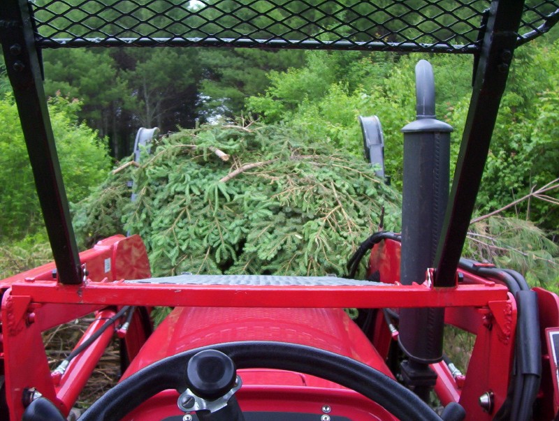

It is attached to a cross piece that rests on brackets that are on the loader arms. This same support is used for the canopy. Had a fair size tree backfire and fall on it Sat. I just :D when it happened, and didn't have to worry about getting facial reconstruction surgery.
The arms in the air - front of tractor - are grapple arms on forks. It will take a large amt. of brush.

   / Bumber for 5500 fwd #6
Here is that pile of brush from the front.

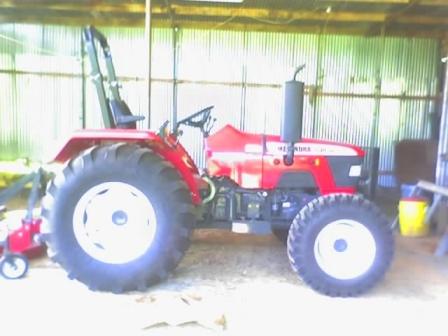

Here is one I made for my 4530. I don't have a FEL and I didn't need a full cage, just something to keep the limbs out of the grill. The bumper is kind of narrow because of the turning radius of the tires.
   / Bumber for 5500 fwd #9
Another one after installed. I'm sorry, but you can barely make it out from the side on this pic. I will try to get some better ones posted.
   / Bumber for 5500 fwd #10
The materials used were:
(1) piece of 4"x27" pipe
(2) 4" pipe end caps welded on
about 8' of 2 1/2" x 1/2" flat stock for frame
(2) 7 1/2" x 9" x 1/2" plate for brackets
30" x 30" perforated metal for screen (cut to fit and welded in place)
I think it turned out pretty nice and is there to stay.
