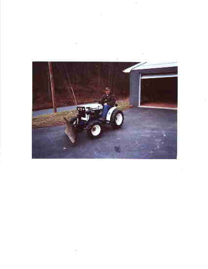

Oh as far as the brushgog I figure the bolts are right hand thread and probably would come loose also that I still could not use a pile of other attachments like my sprayer and hydraulic pump etc. etc. so is a must to go clockwise..here is a pic of me and el beaver' hahaha damm old lady always taking pictures hahhaha
