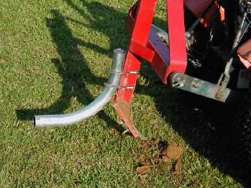

You can take the share off of them and replace with a smaller point share to make a shorter version of a sub-soiler too. As I did to make my pipe laying tool. (see the thread "Laying Pipe" and attached picture)
