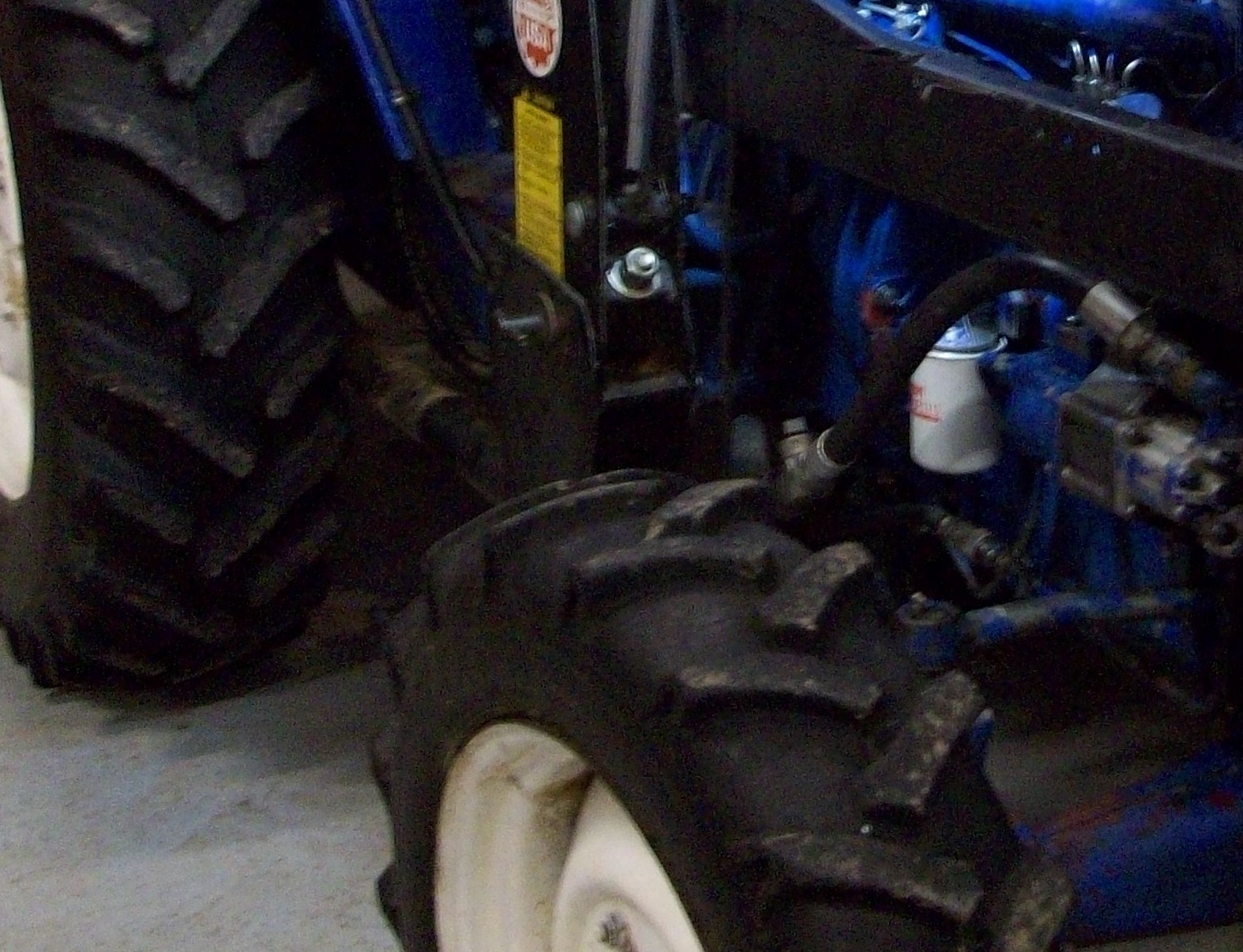

Can't speak for the tractors smaller than my Rhino 554, but this is a (k2 Koyker model #2) rhino-injector rebuild 001.JPG and it does have the rear axle to loader center mount braces. Would think Koyker knows the smaller tractors need the reinforcement just as much as the larger machines...
   / bus hog brand loader on a ym240 #10
Can't speak for the tractors smaller than my Rhino 554, but this is a (k2 Koyker model #2) View attachment 337847 and it does have the rear axle to loader center mount braces. Would think Koyker knows the smaller tractors need the reinforcement just as much as the larger machines...
I didn't know if Koyker made them for yanmars or not. I haven't seen the braces on any yanamrs I've seen. For what ever reason my 3110 doesn't have them . I don't remember cardoc ever mention any braces on his Koyker loader It would be interesting to know if Koyker makes the braces for only some Yanmars,but not all
