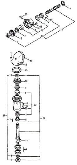

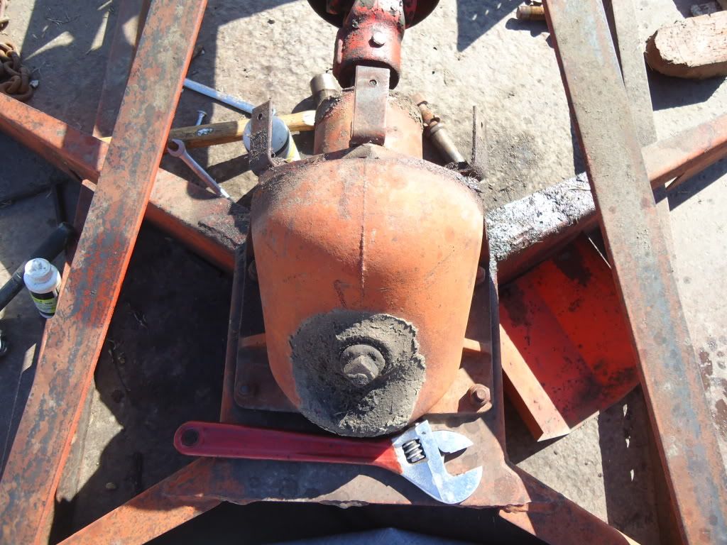

Did clean the input shaft off of mine .. Harden Grease that looked solid. After almost using a chisel - it was splined ...
So it's a splined input .. not sure what's below to the cutting blades ..
This Bush Hog is a 7’ cutter rated at' 40 hp minimum up to 107 hp .. not sure of the year.
Took the input flange off and found the gears are shot .. Input flange housing is cracked ... Figured whomever had it before had to have hit something really solid to cause that type of damage.
Did find an exploded view drawing of the gearbox .. this one is a bit unusual compared to the type today..

I know the input shaft (one from the PTO Shaft Knuckle) is a standard 540 splined shaft .. Length unknown
Output shaft to the stump jumper - from the diagram shows to be a possible taper shaft with a key and held in place with a nut ....
The other issue I have is the gearbox does not mount directly to the pan of the cutter. It has a standoff (bad idea) that looks like approx 8" ... I will take a pic and measure that as well ..
It will be a little time before I can flip over the cutter to remove the stump jumper/blades ...
