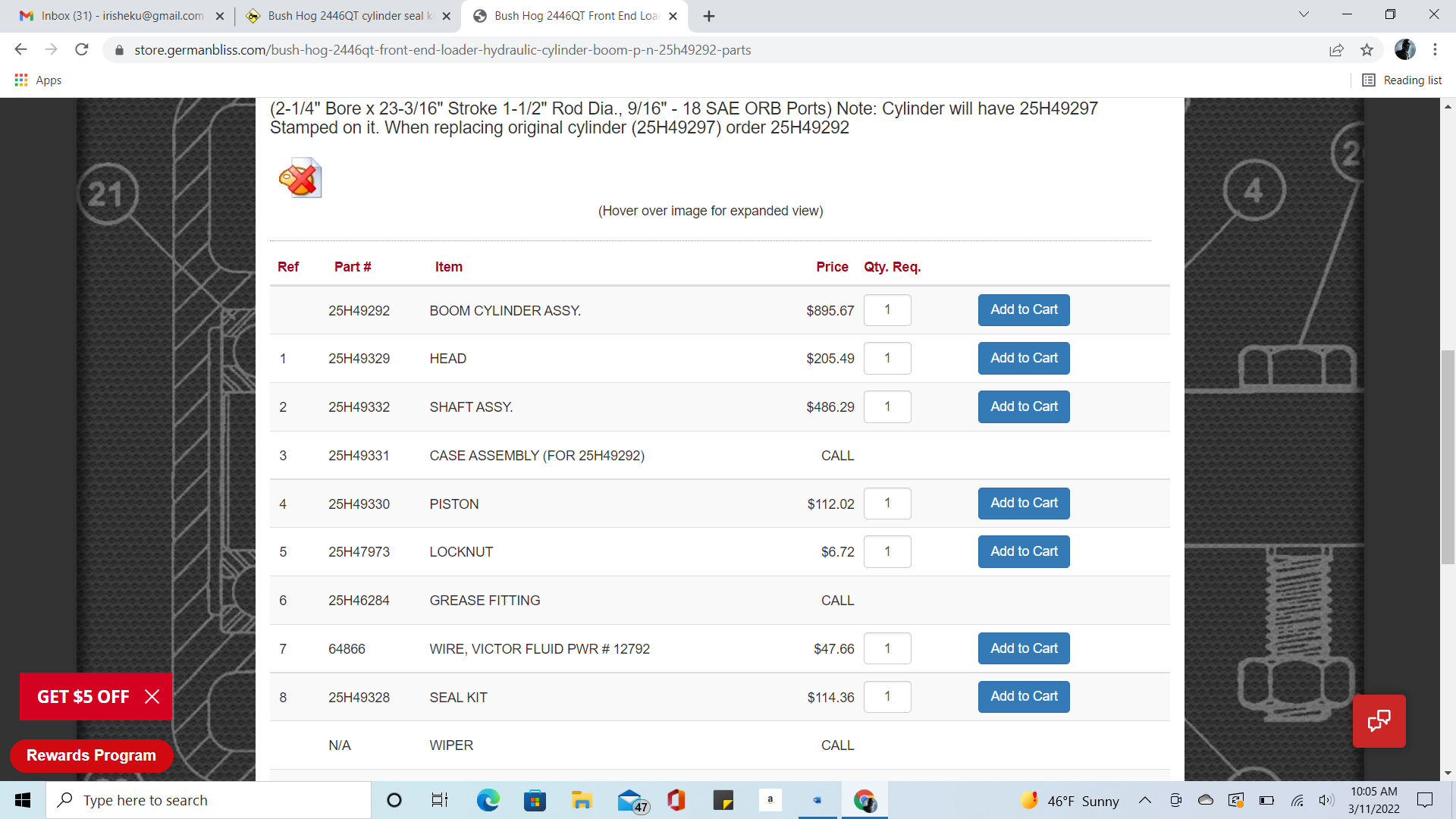

Hello,
This is my first post here but I've lurked and learned a lot over the years. I've got a Bush Hog 2446QT loader on my Kubota M8200. The right (sitting in seat) bucket cylinder is leaking and I'd like to get a new seal kit. The cylinder is stamped "25H49298". I have looked and been unable to find this, so I'm wondering if someone can tell me if another kit will be compatible.
From the bushhog.com parts finder, I can see this, but the part numbers are off - 25H49297 vs 25H49298.
Thoughts or suggestions much appreciated.

If you have a place local that rebuilds cylinders they can measure your seals and get you a kit.
   / Bush Hog 2446QT cylinder seal kit help #3
Sorry but your link is bad, or removed for some reason. Google Fu showed me a web page "Duetch Wonne" and according to your PN# from cylinder , the seal kit is : 25H49328
