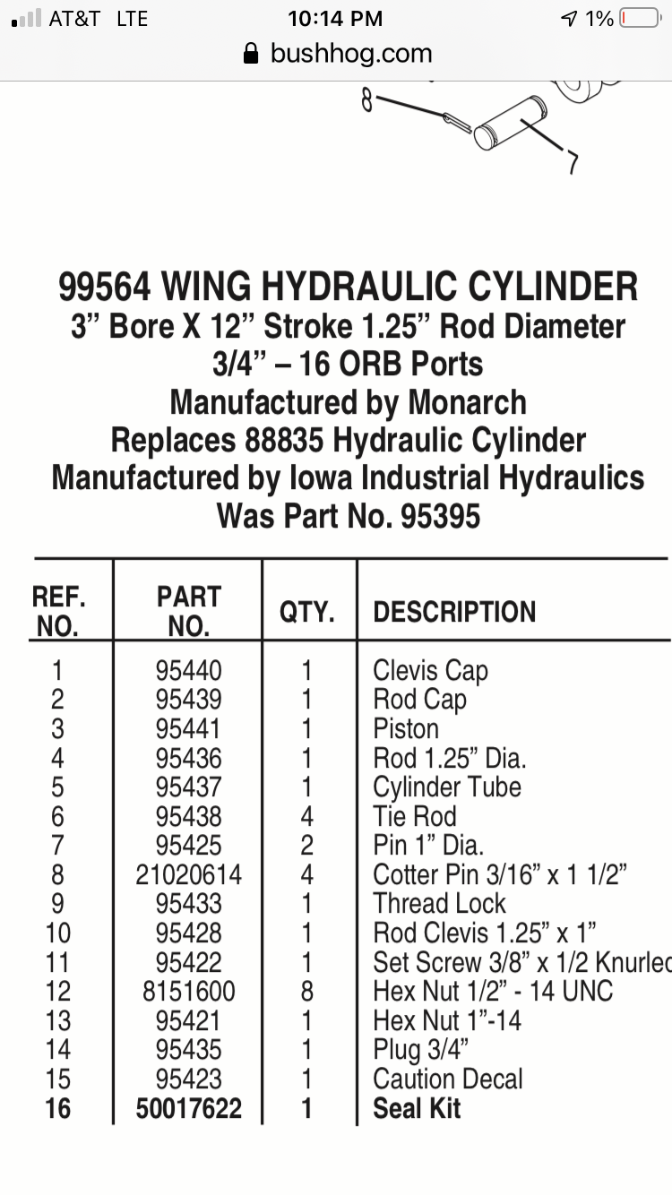

Does anyone know the retracted length (pin to pin) of bush hog cylinder 99564 made by Monarch. I can fine everything except that

I would think Bush Hog would use a standard cylinder size, so 22 1/4"
