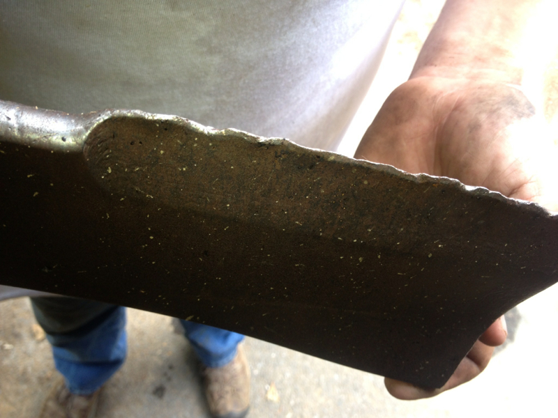

   / Bush Hog blades #6
Take them to a weld shop or if you have a welder do it your self. My friend has a strip of copper that he lays the blade on and welds a bead or beads along the edge sharpen's them to around an 1/8 inch edge, and balances them to approx the same weight.So far he has had good luck doing this and no problems with shaking the deck apart.
