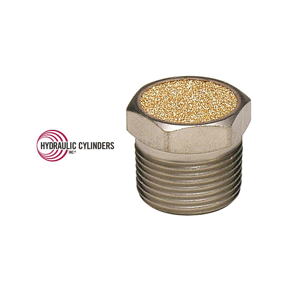

So the Axel cylinder (up and down) on my bush hog 2615L batwing has locked up and will only spit fluid out of the breather.
Do I need another single acting cylinder to replace it with? or can I use a double acting and just run another hose to tractor? DA seems to be cheaper and easier to find.
Or can a DA cylinder from tractor supply be used as a SA?
Thanks for you input.
   / Bush hog deck raise cylinder SA to DA #2
You can use a DA cylinder just take the vent out of the old one or buy a vent........... breather-1.jpg
