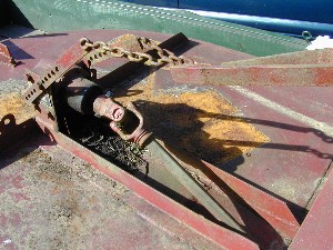

I just traded a case of Coors light for this old bush hog. I haven't had any experience with a bush hog since a teen in high school, and I need some info about a couple of things, and would greatly appreciate any help anyone has to offer. I know the blades need sharpening, as the leading edges look to be about as sharp as a 1/4 dowel. In other words, totally rounded over and a little rusted. The gearbox turns the blades very smoothly by hand, with no forward/backward play at all, and no stiffness or grinding. I am pulling this behind a 1955 Ford 640. The fellow I got it from advised me to use case hardened bolts in the drive shaft hole connecting the shaft to the gearbox spline to prevent them from shearing so often, so I bought about 10 bolts to use for this. However, a fellow at work advised me to use regular bolts, as I want the bolt to shear to prevent any damage to my PTO drive. What is correct here? I don't want to be changing bolts out every 5 minutes, but I don't want to tear up my tractor or bush hog either. Also, the top links of the 3 pt hitch, have been cut and section of chain welded in (i'll post a pic showing this in a followup post). Should I change this out to solid top bars or leave the chain in? Previous owner said this allows the bush hog to ride up and down slighty over ridges. Any thoughts??? Also, let me say that I have only recently found this site, and I think it is one of the best sites around regarding rural living!!! And it is great to have such a valuable source of information and expertise! Thanks in advance,

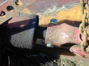

Picture of the chains which were added to top links of bush hog.

You don't want to use case hardened bolts for your shear pins. The shear pins are there for a reason, and that is to protect your tractor PTO drive. Buy shear pins from your tractor supply or use #2 grade bolts. I run a 6' rotary cutter and have only sheared 2 bolts in over 4 years. And that includes cutting some pretty heavy brush and hitting some pretty substantial deadfall and other junk washed up out of the creek.
As far as the chain, some people prefer a chain to a regular top link. That gives it more latitude to move up and down over uneven ground. Some concern has been expressed about hitting a stump or other object and the mower deck flipping up and over. I think that is very unlikely unless you have a LOT of HP and a LOT of traction.
   / Bush hog drive shaft/pto question #4
Ken, as has been said, I'd use grade 2 bolts; much rather have to replace one of them than damage the tractor and/or mower. As for the chains, in 1995 I bought a new Bush Hog squealer that came originally with chain instead of the solid bars; don't know why they changed, but if it were me, I'd just leave the chains alone.
   / Bush hog drive shaft/pto question #5
I'll chime in and support keeping the chains. I just converted mine to chains and now don't have the steel straps bending when the rear of the deck comes up (like when backing into an up-hill slope). Watch that the chains don't entangle in the un-covered PTO shaft (is it missing or just off for the pictures?).
Also, I support the shift back to shear bolts, not hardened ones. Hopefully the previous owner hasn't already damaged the cutter's gear box. Otherwise, if too many busted shear pins, look into a PTO clutch (maybe two cases of beer if you get the right person /forums/images/graemlins/grin.gif )

<font color="black">There is no cover. As a matter of fact, there is no cover on the PTO at the tractor either. Maybe I should get one. </font>
