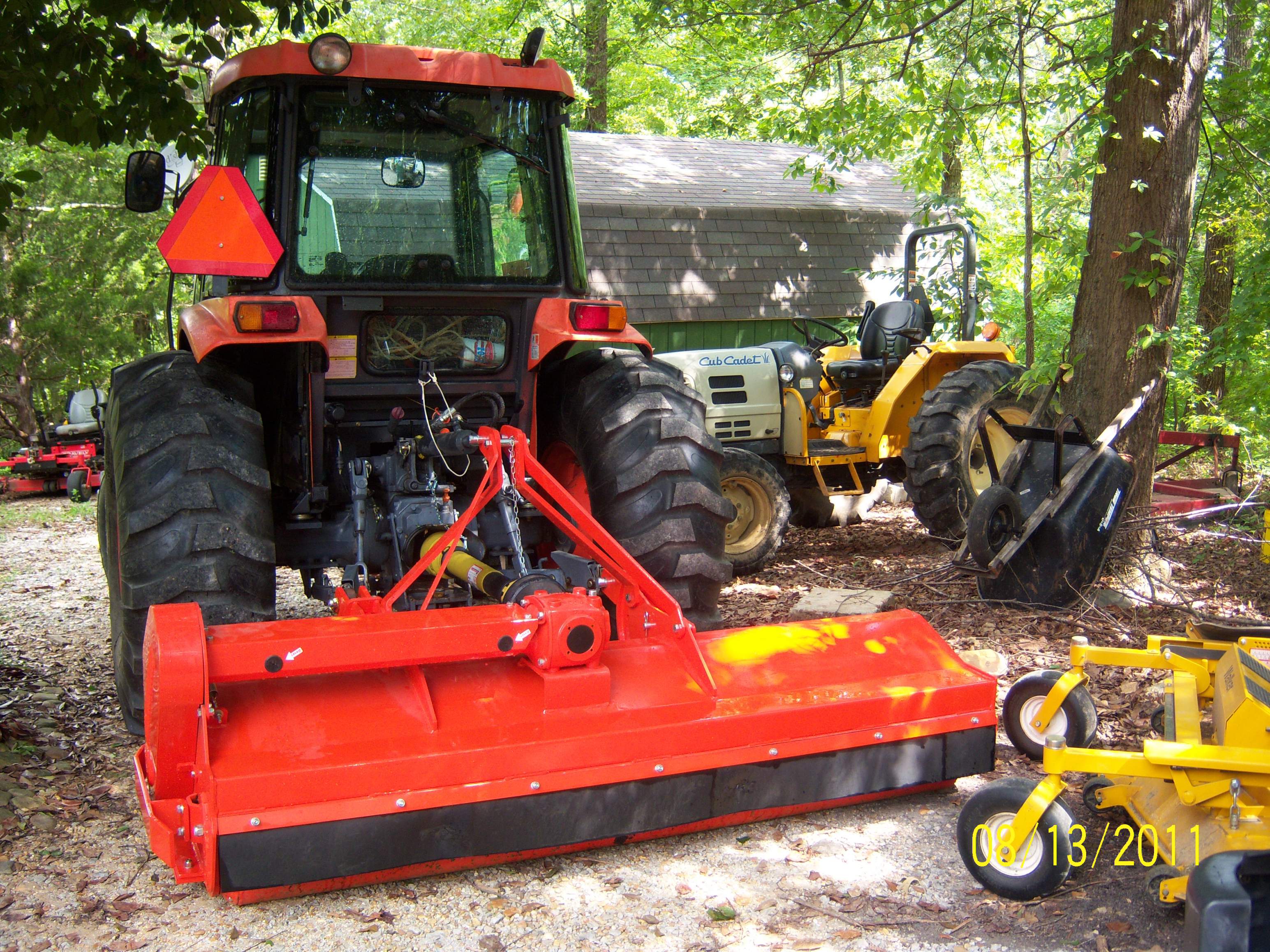

i got this one last year from everythingattachment.com
I cut fields for a living durring the summer and it did just fine on tall grass now i mean grass not small trees. if your wanting to cut heavy brush get a regular rotory bush hog. i use both depending on the type of field im mowing
