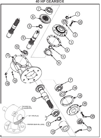

As everyone is saying, there are tons of resources online to look for your parts and also many manufacturers. I'm attaching an illustrated parts diagram of a King Kutter 40hp gearbox.
If you can identify your cutter, I'm sure we can help. If you can't identify it or get a picture, you could search for months before you find out what brand it is.
If you are interested, I do know from first hand experience that many gearboxes from different manufacturers are interchangeable. It just depends on the design of your cutters blades and stump jumper (if it has one) and the spline type. It's also critical to know if the gearbox is 40hp, 60hp, 80hp, etc..

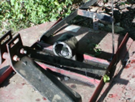

ok i think i got the pic small enough

   / Bush Hog Gear #6
</font><font color="blue" class="small">( ok i think i got the pic small enough )</font>
Yep, you got it so small, it didn't even show! /forums/images/graemlins/grin.gif /forums/images/graemlins/grin.gif John
   / Bush Hog Gear
gear thats history
/forums/images/graemlins/laugh.gif

   / Bush Hog Gear
Thank you for the pic it looks like part #8
   / Bush Hog Gear #9
</font><font color="blue" class="small">( gear thats history )</font>
AHA! Ya fooled me! /forums/images/graemlins/wink.gif /forums/images/graemlins/laugh.gif /forums/images/graemlins/grin.gif
   / Bush Hog Gear #10
Your toplink attach point (long slot) looks just like my Howse. Also your gearbox looks like it was painted black. That's also the way my Howse is. Yours looks like the 300, 350, 400, 500 series of cutter.
Here is a link to the Howse website major parts for your cutter. There is also a phone number on their home page and I bet they can help you. I think that entire gearbox is about $175, but the internal gears may be a lot less.
