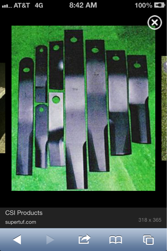

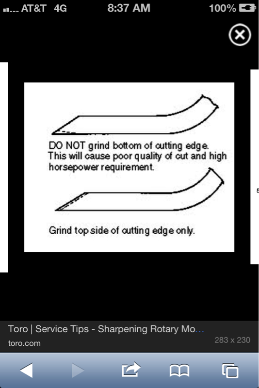

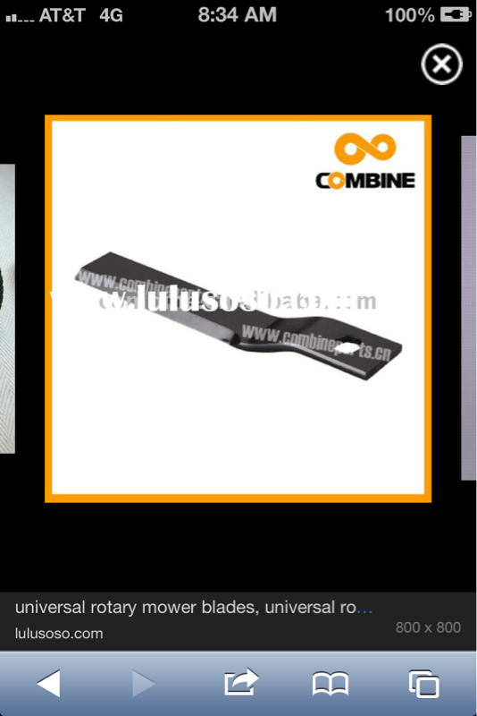

This may sound crazy but I have seen it, newer cheap rotary mowers (commonly referred to as brush hogs but not referring to that brand here) have flat blades instead of blades with the upturned trailing edge behind the sharp edge. They, the flat blades, leave these clumps. The upturned blades, as all lawn mowers and lawn tractors have, are designed that way to created a vacuum lifting action which pulls the grass you've run over back up and cleanly cut it, the flat blades cannot do this so you generally see these clumps standing randomly all over the fields in thick grass. They work fine in briars and brush.
/ Bush Hog Issue #13
This is a picture of the flat blade.
This is an example of the up turned blade.
/ Bush Hog Issue #14
In this picture the blade at the far right would have the most lifting action and leave the least clumps. The ones with just the corner turned up have less lifting action but are still better than flat blades.
