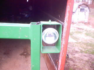

After much effort I hope that I can now post what I did to mount lights that would not be in the way or to get busted off by trees and branches . I have a JD990, but this will work for any tractor with a ROP and can be fitted to mount with a canopy.
Before this last jump in scrape steel I went to the local steel shop and got a scrape piece of steel tube that was big enough to mount a set of Driving lights in , I cut it so I had enought to make two sets of mounts , 4"x5"x6" . I drilled two holes that matched the canopy mounting holes on the ROP, one hole to run the wires for the light , and one one hole on the top to mount the light inside of the tube . I painted them to match the tractor color , the mounted them using 12mm bolts . the wiring I run down the inside of the ROP and back up under the seat to the main wire harness were I back wired to the fuse block , making sure to have conectors at the split point just like the factory harness for that possible need for service . I rrun the lights through the factory switch , time will tell if I will need to replace this and up grade to a relay system for the lights .

OMG! You've been hangin around with Henro, and drilled your ROPS didn't you! Seriously, that looks like a good arrangement. The only problem will come if the tractor turns over, one will probably be a little mashed, but that's not terrible. Looks like it will give really good protection in those woods. Good work. John
   / Bush Hog Proof Lights #5
While my opinion is completely unsolicited, with that style of ROPS with the 90 deg. corners, I prolly woulda put them on the inside corner ...

Lost my home PC' , but No ROP was drilled for this install ... the JD990 has pre-drilled and threaded 12mm hole for the install of canopies or cabs ..... ..
as for damage to them if it is rolled over I am thinking I will be wooried about something more than a busted light ... /forums/images/graemlins/shocked.gif /forums/images/graemlins/blush.gif /forums/images/graemlins/tongue.gif

Donw boy...Down! You needn't defend what was a nice install. My opinion, nothing to do with rolling the machine, was based on the fact that I can pretty much guarantee on my land that those light would take a beatin bein on the outside of the ROP ... thaz all.

Nice, it gives me some ideas, like using driving lights for a car or maybe even using tractor utility lights with a togleswitch on them.

</font><font color="blue" class="small">( as for damage to them if it is rolled over I am thinking I will be wooried about something more than a busted light ... )</font> LOL. I bet you would be. I hope you never find out. Nice job, I think they will be strong enough to resist damage even on the outside. John
