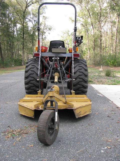

Common problem.
The current L3200 has Position Control. The preceeding L2800 may not have Position Control.
Without Position Control you need to install Zerco Check Chains to maintain front of the 'hog off the ground. Especially with a heavy mower and an older, hard worked tractor.
SEARCH "ZERCO" HERE ON TBN.
[None of the Kubota BX nor B series tractors have Position Control.]
Check chains are silver in photo. Zerco kit includes chains and attachment/adjusting brackets for tractor and attachment brackets for rotary cutter. $30. Zerco check chains have been used since the 1920's.
Once you get chains on, set mowing height you desire at front by adjusting chains through tractor chain adjusting brackets. Then bolt tail wheel bracket so deck is 1" higher at rear.
Secure extra chain so it does not foul revolving PTO shaft.
   / Bush hog setup. What am I doing wrong? #10
Why don't you post a photo of how you have the Top Link connected to Floating Link on the rotary mower? Maybe a couple closeups of the Floating Link from different angles? Floating Link, when correctly assembled, should maintain 45 degree angle when Top Link is correctly tensioned.
I have seen mower Floating Links incorrectly assembled, incorrectly mounted, and both.
