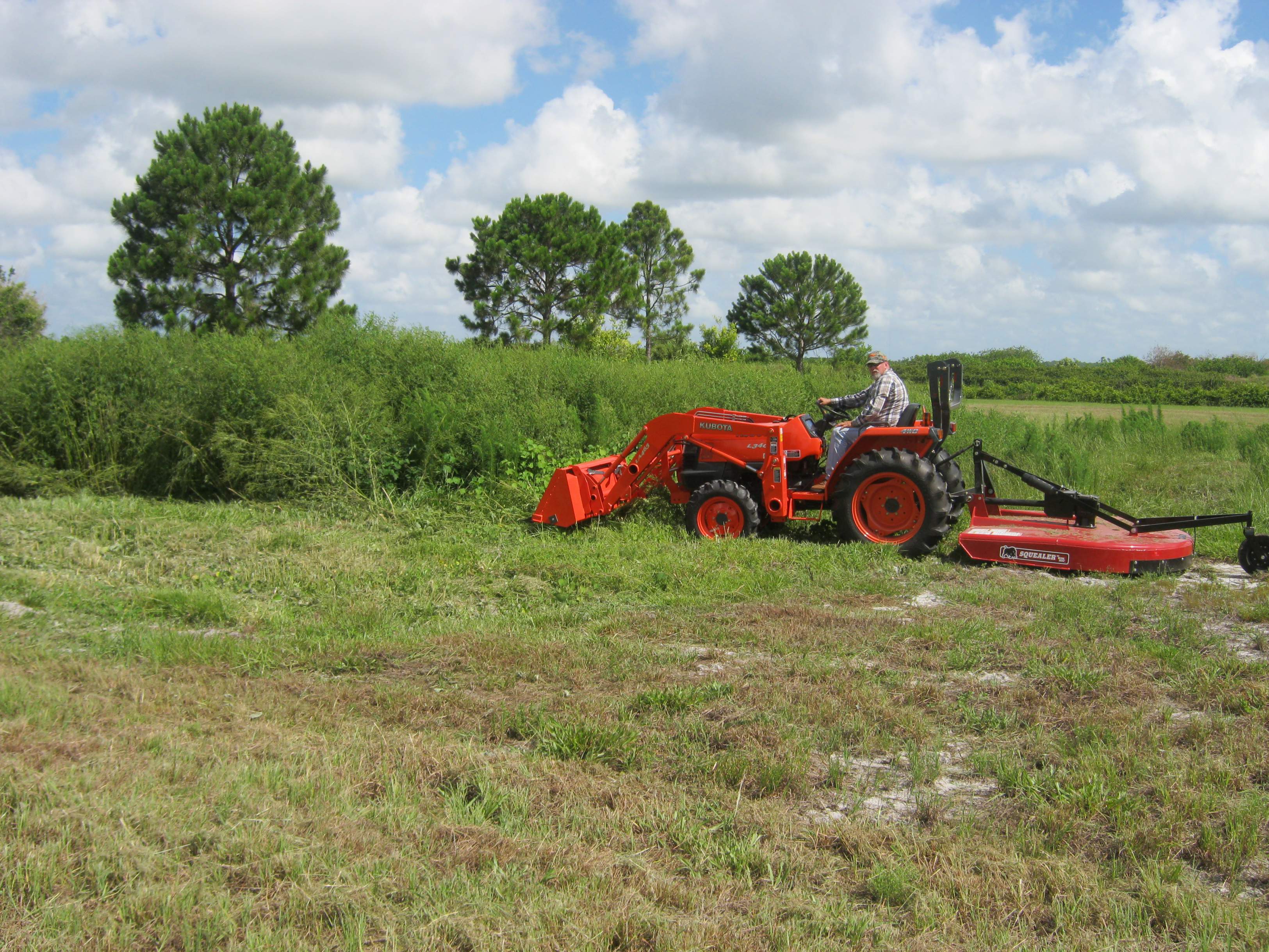

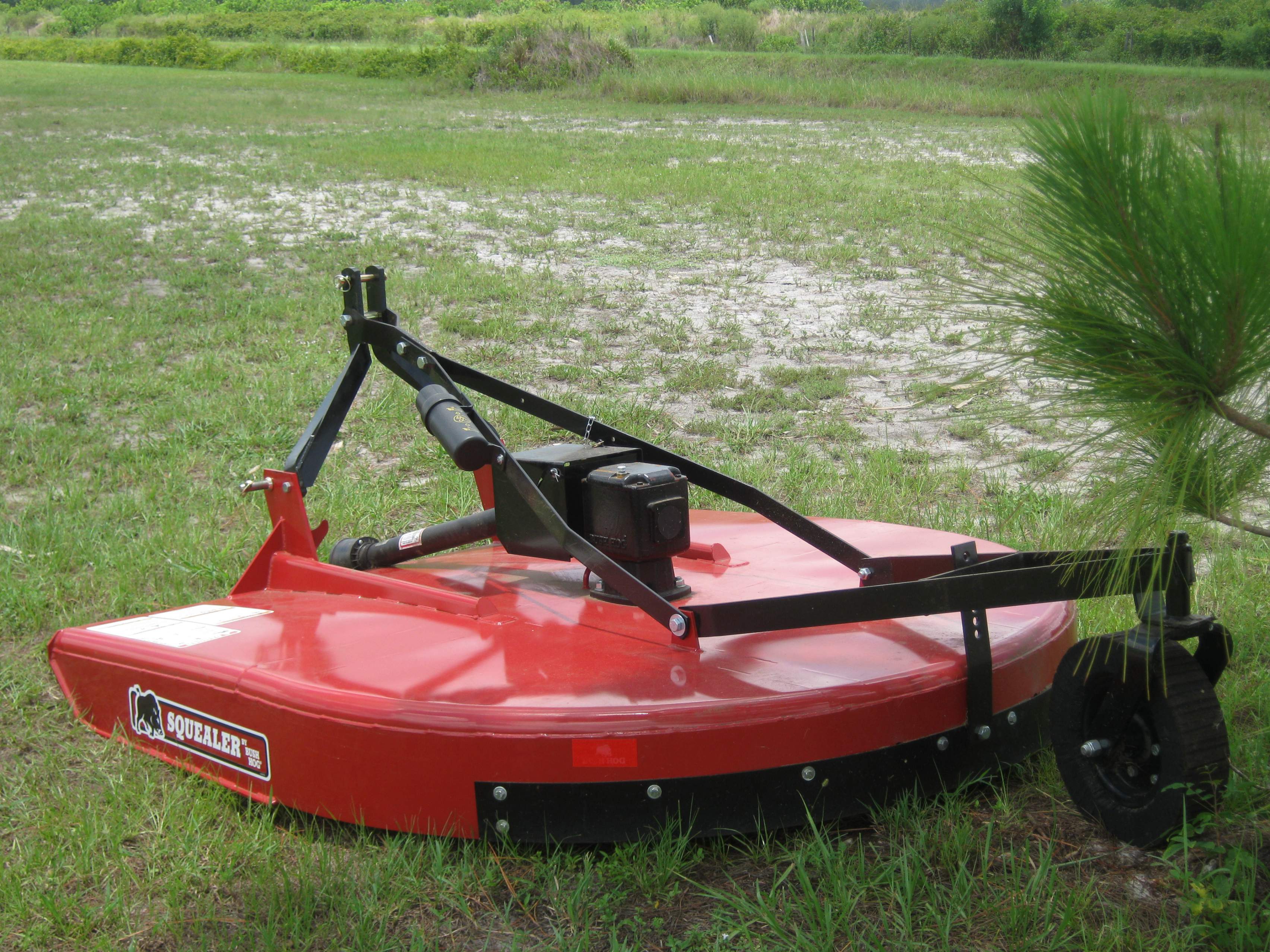

Can't speak about Land Pride RCF2072. I have owned my SQ172 for about five years now and it has been rock solid :D :thumbsup: ! I pull it behind my L3400 Bota DT (gear). Don't use it for commercial work, just the mini mini hobby place on almost 6 acres. Maybe it just me but I've looked at pics of LP and they rate their gearbox at 65 hp I believe also, but can tell you my BH brand gearbox looks way bigger. I don't have chains on mine just those heavy plastic looking guards. If I had to do it over again I'd get the SQ172. Been real happy with it. Just my :2cents:.
