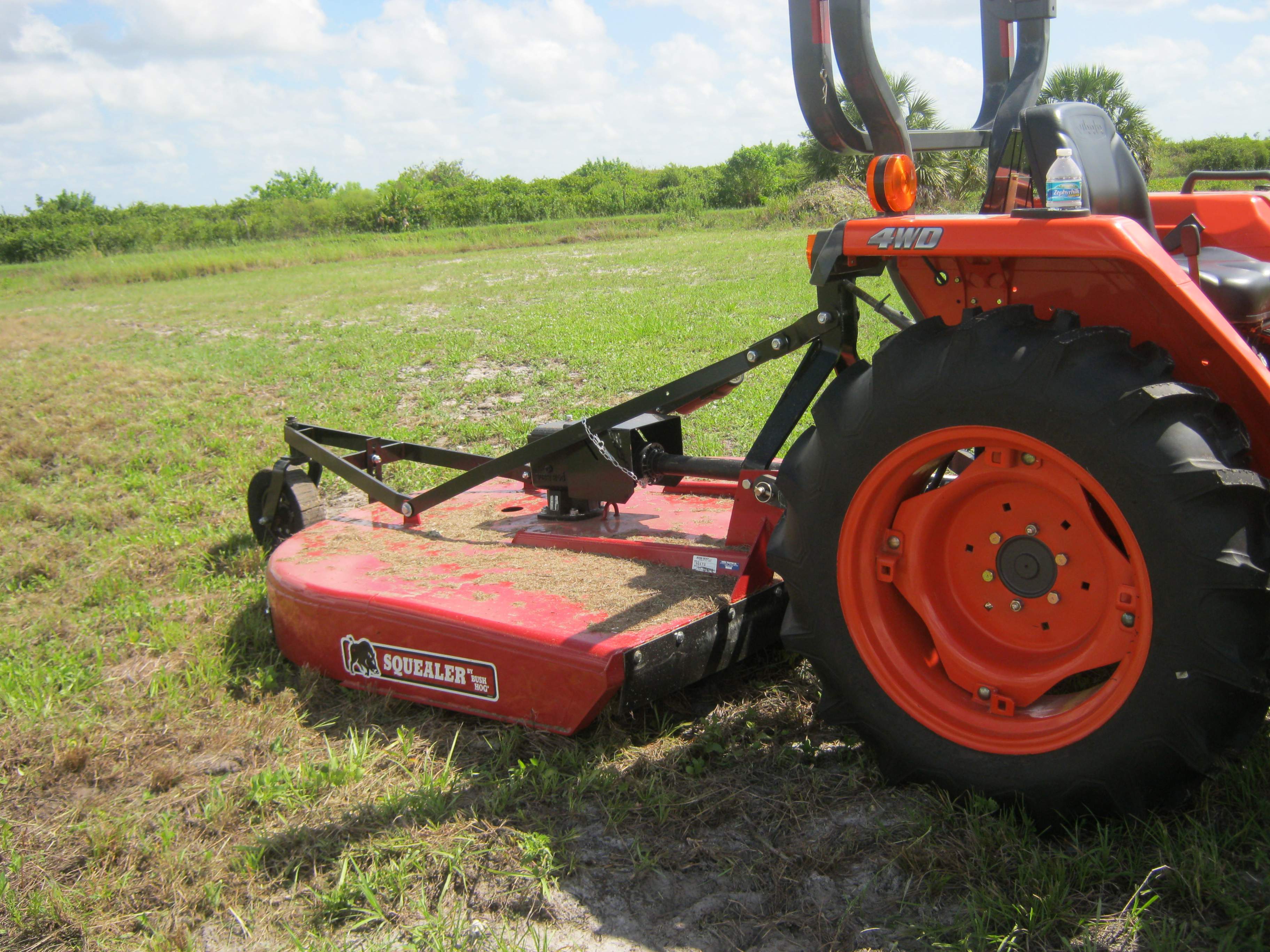

   / Bush Hog Squealer (SQ148) vs Current Model Cutters #7
I have the six foot version SQ172 with about 200 hrs use. Its been a winner. Lives outside also. A lot of the bush hogs come with cloned Chinese gear boxes nowadays. One of my reasons for me purchaseing this one was the steel guage difference. Another consederation is size HP of gearbox ! Something you (OP) might want to look into. I'd offer him the $1200 and gave him first shot at completeting a sale. I also think $1500 is steep. I"am sure it comes with rubber trash guards and not chain guards. Chains cost more . Just my :2cents:

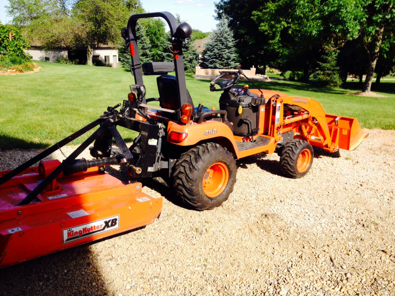

I've had a King Kutter XB48 for 2 years, no problems. I cut and maintain ATV trails on 200 acres. It cost $850 new.
