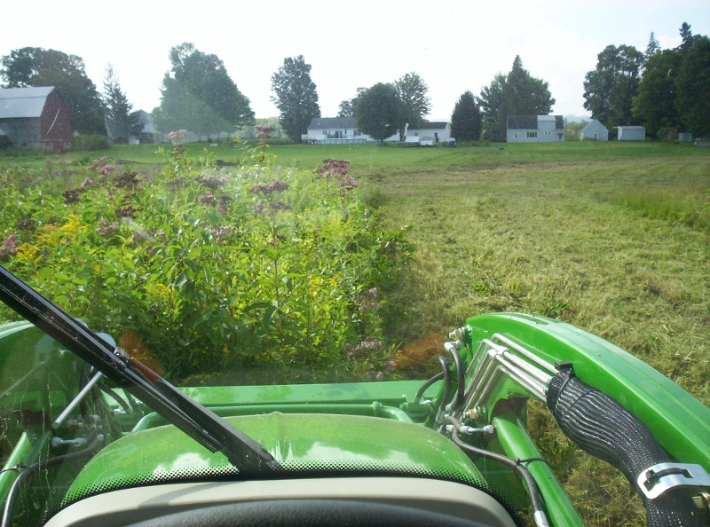

   / Bushhogging speed (acres per hour) and the like #7
Last time out the best was about 3-3.5 mph alot at 2.8 mph. 6' hog, very rough ground.
