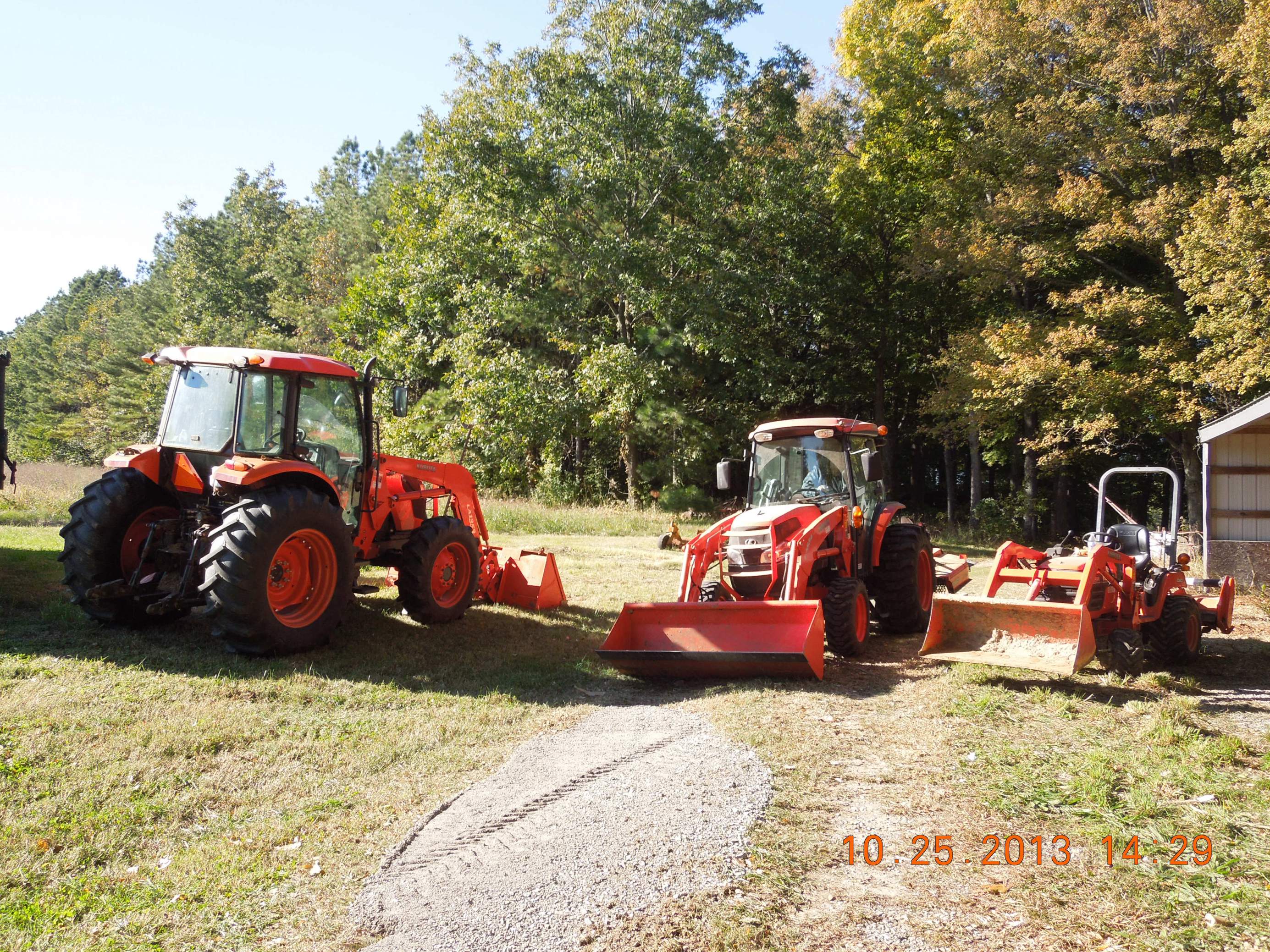

Pretty much what everyone else said, you won't regret the BX, will get a lot of work done as well as experience in tractor operation. I used a BX only on my primary property for many yers and it still gets a good tractor workout from time to time in spite of owning other, bigger machines. We have R1 on one and R4 on another as well as our JD1025R.
