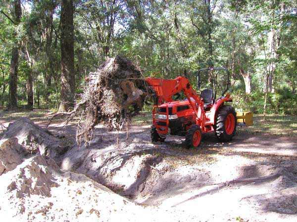

I passed on the heavy duty bucket on our L-3130 875 working hours ago and purchased a nice tootbar for the stock bucket instead, haven't looked back since..... /forums/images/graemlins/wink.gif

I'm not the best one to comment since I have a four way skid steer bucket, done all sorts of stupid things with it and I just think that other things might bend before it does.
Anyway, you might step back and think about YOUR conditions and what you plan to do with your tractor. I would tend to think that if you are moving stuff like horse manure or bark the light bucket would be fine. Or add the bracing to a light bucket depending upon your planned use. But some things might require the heavier bucket? I had the dealer come out and look at my property and what we were planning to do, his advice did change some.
I will say a hook or two is great, use the one on my bucket often!
