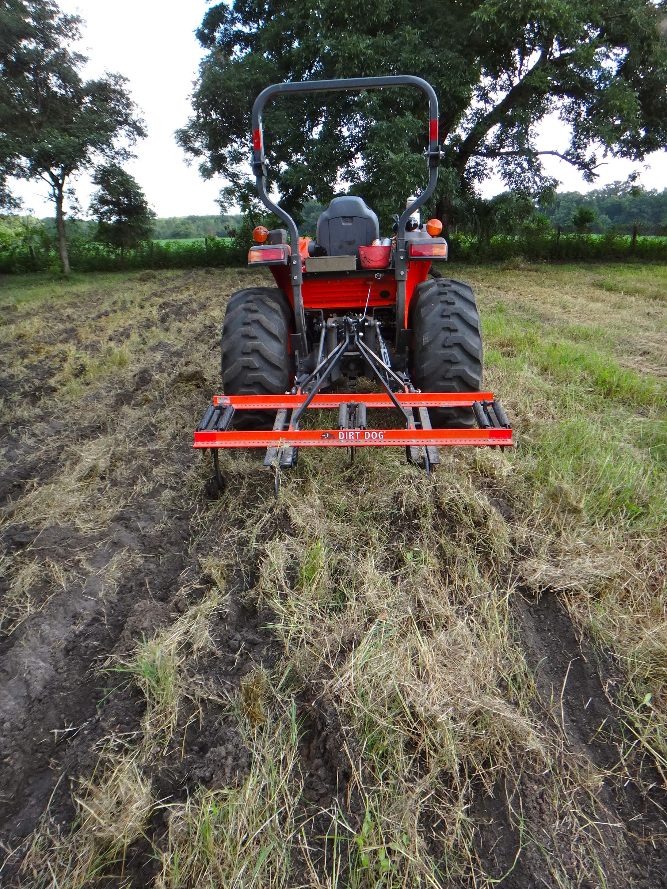

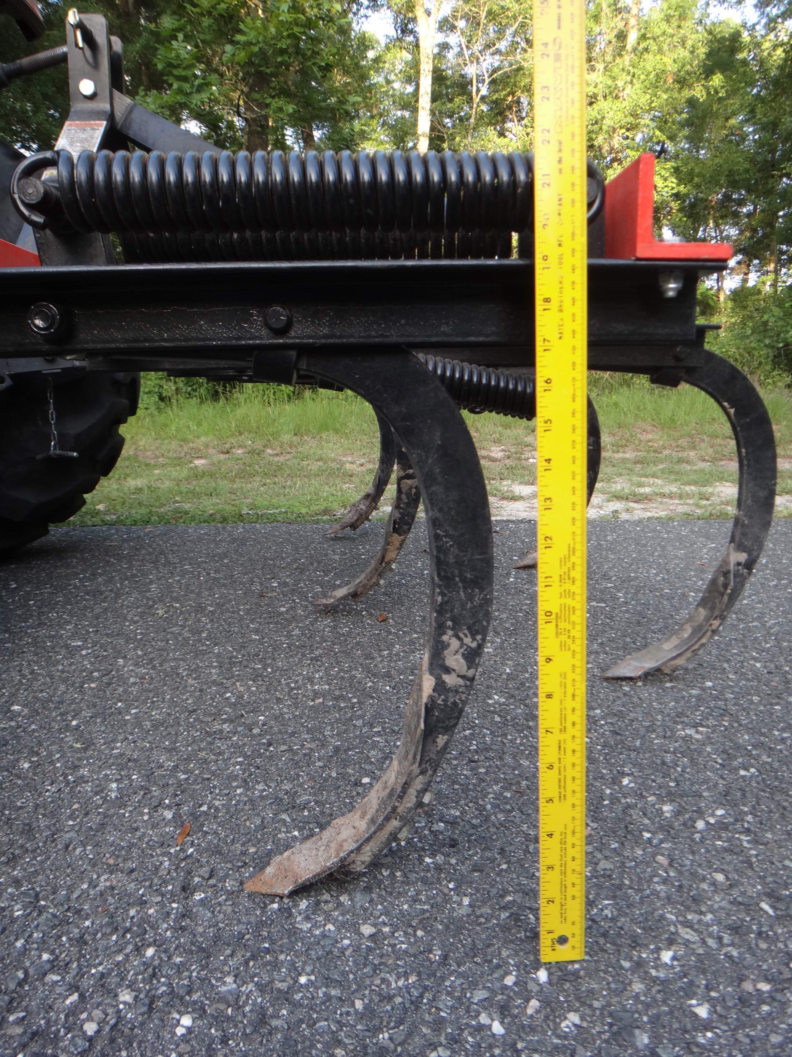

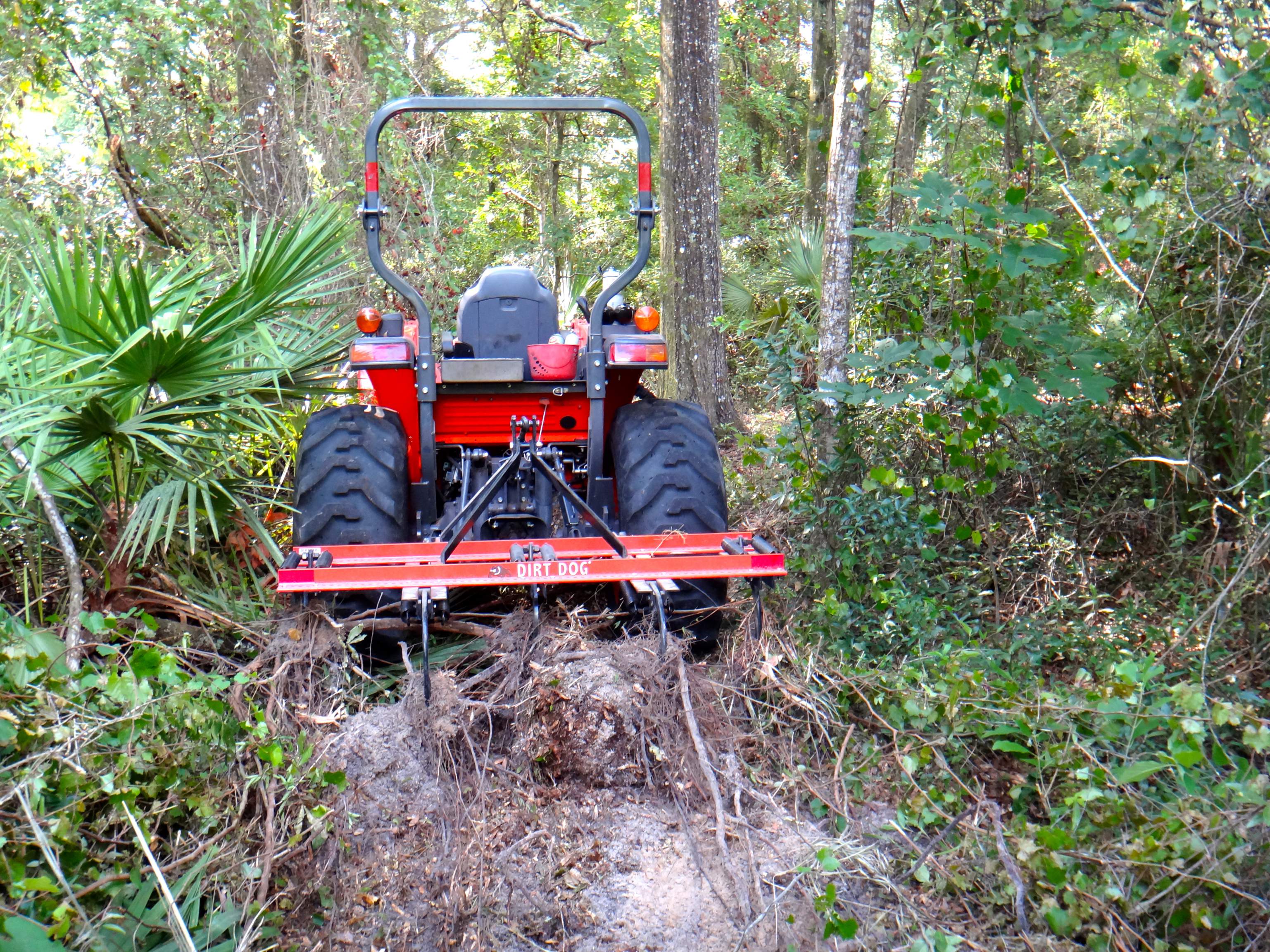

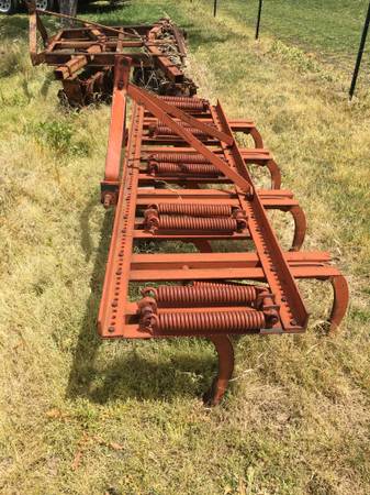

I speculate a three shank Field Cultivator/All Purpose Plow will work, but not down to 14" depth ~~~~ perhaps to 6" or 8" in MOIST soil, ample for your food plot. Question your vender to be sure your relatively small Three Point Hitch will have enough vertical movement to lift implement high enough so tine points do not drag in the dirt.
Assuming the inboard end of your Top Link has a least two pairs of pin holes on the tractor, one pair above the other, lower pin hole pair will allow higher APP lift.
MORE: https://www.tractorbynet.com/forums/attachments/339095-dirt-dog-all-purpose-plow.html?highlight=
   / Buying a disc for deer food plots
Hmm...wondering if I can fabricate this given the issues of size and number of shanks.
   / Buying a disc for deer food plots #9
The spring protection allows just enough give in the shanks for the tractor to overcome hard spots in the ground without stalling.
Old Field Cultivators/APPs show up for sales pretty often, though usually starting at five shanks, with seven shanks perhaps most commonly found.
I recommend finding an old FC/APP, removing all but three shanks, testing, then cutting down the frame.
Ferguson 3-Point Hitch 7-Foot All Purpose Plow, Good Condition , NO RESERVE !! | eBay
Tyler, Texas' Craig's List is the venue to watch.
Spring is the least productive season to find/buy used plows ~~~ they are in use.
Found a FC 7ft open to offers...what is a good deal? Would love a steal, but don't want to insult anyone.
