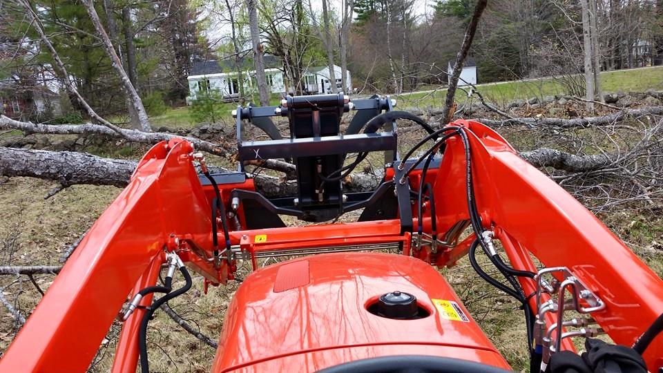

Attaching and removing the grapple is a bit of a different story. Angle is trickier the way that implement wants to lean when resting. Will have to build some stands to drop it into, I think. That and remember to disconnect the hydraulics for that one ;-)
Just concentrate on getting the top edge of the SSQA up under the lip of the grapple portion of the SSQA bracket.. Curl up or Dump down to get that top edge hooked, then lift and curl back, it will swing down by itself to get the pins lined up with the slots on the grapple portion. yeah don't forget the hydraulic lines.:)

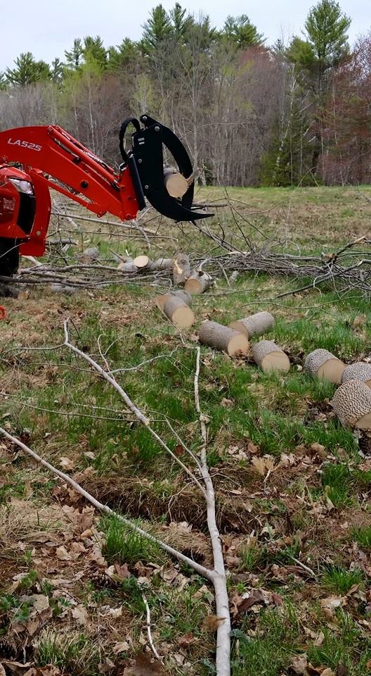

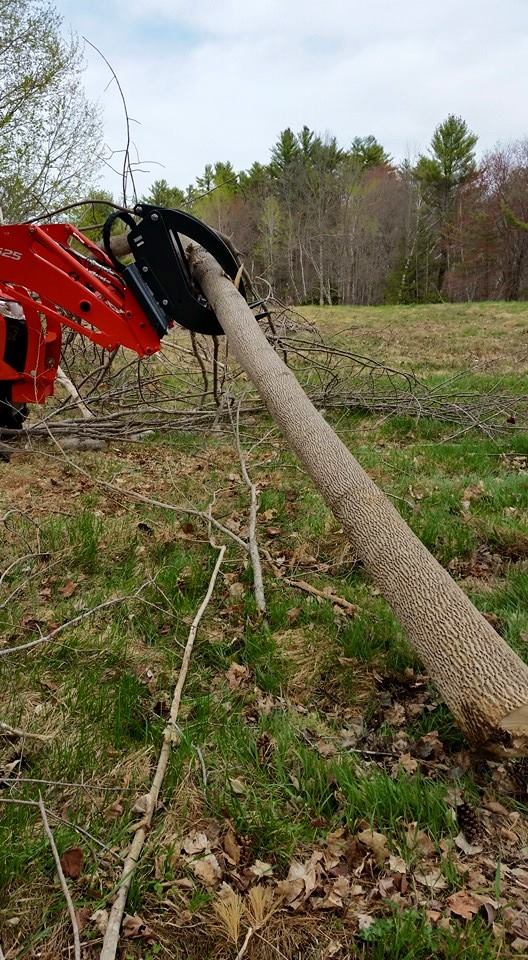

That said, that was a heavy and solid ash tree and I had it up at a decent height in the grapple for chainsaw access and didn't notice any instability. Though I heard 0lenty of whining. More careful forum reading has me going to Low (was in Med) next time now, D'oh!

Nice. Just looked at the specifications. My cutter is 478LBs. It's the RCR1260. That probably explains why I was okay lifting the tree in that picture. I know it puts the weight out behind a bit - which probably does one good thing (increases the force a bit to help counter the bucket) and one bad thing (mess with the center of gravity a bit).. And I imagine as I get closer to the woods with my fence line preparation I'll hate the wider corners with that behind me all the time. But having the 500LBs seems to be a nice thing to have back there while I'm doing some of this work (and still getting used to driving a tractor and learning what angles are really scary and what are just feeling scary out of paranoia) and I can let the bank account reset a bit and hold off on buying a ballast box for a couple months. Any problem with using a cutter as ballast like this? Other than the fact that I have a big butt dragging around behind me? When I do the work with the logs, I've been keeping the 3 Pt elevated just a bit so the cutter's tire isn't displacing the weight.

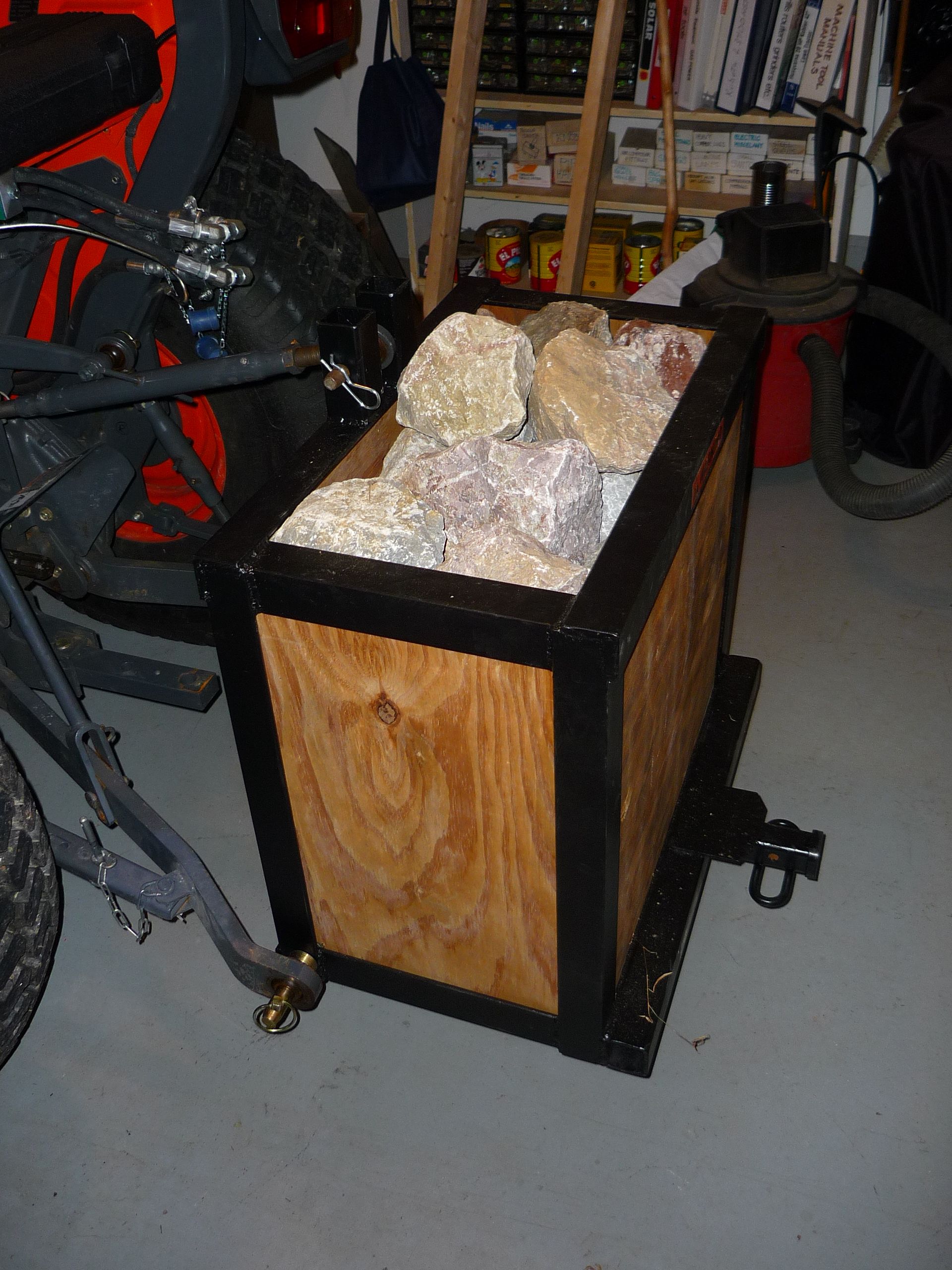

I liked that ballast box- especially the shovel rings. I will add some like that to my home-made box (which is very similar in size, I see.)
