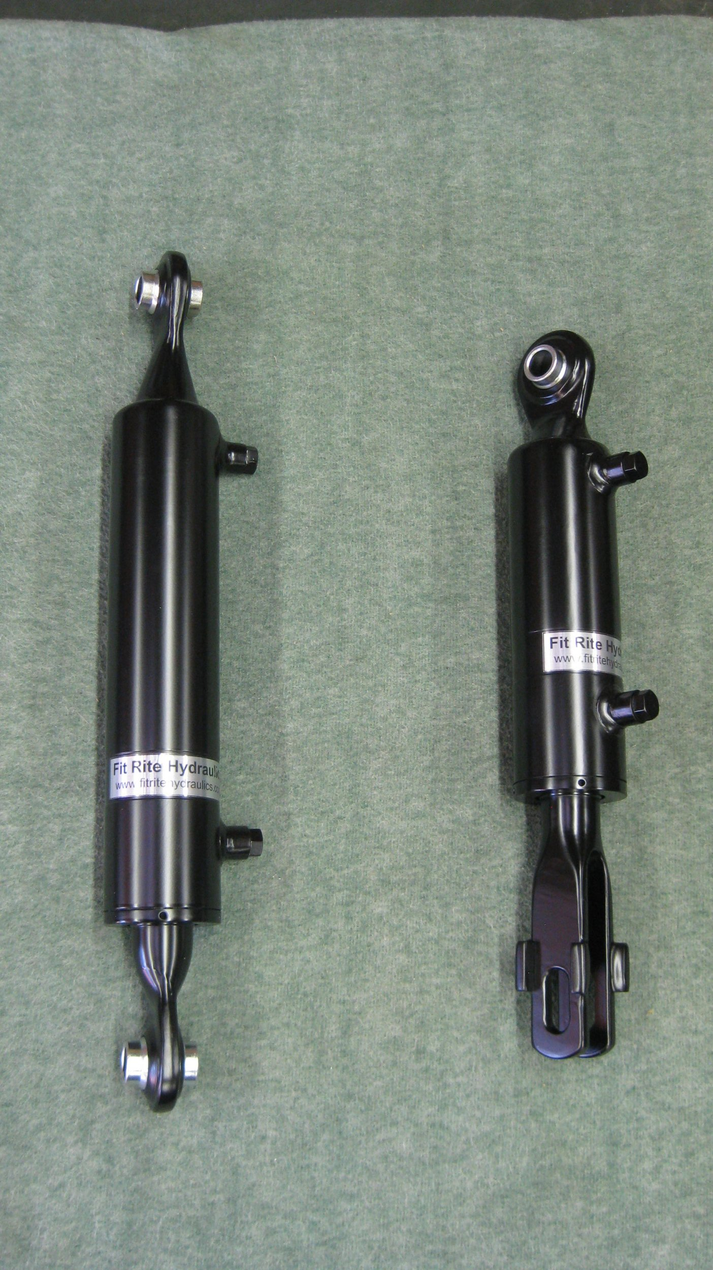

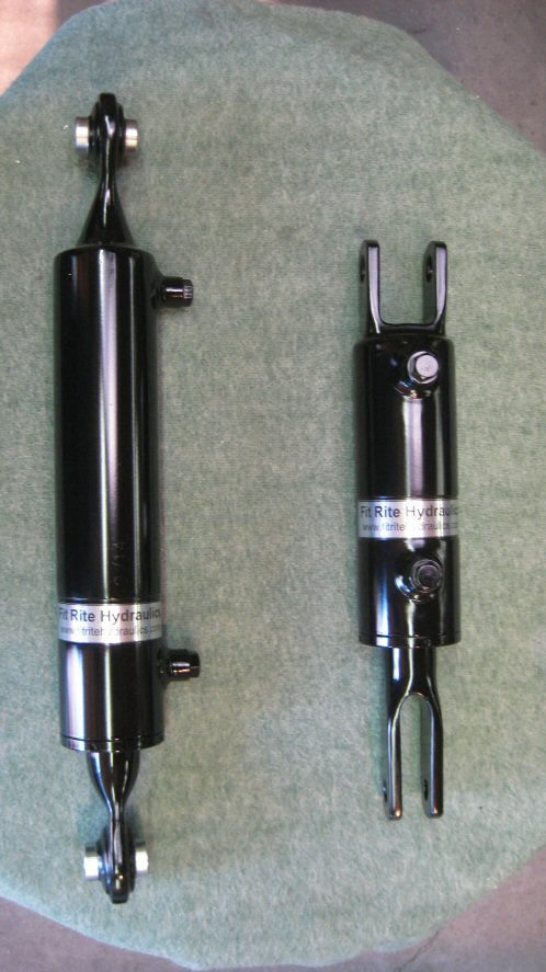

I'm fairly certain that there is no OEM T&T option. But things change and maybe I'm wrong.
I'm not familiar enough with any of those models to say if the rear remote valves have options such as detent, or float or self canceling detent. They might all be 3 position spring return to center type of valves? (most likely)
All of those models should have the T&T cylinders built with 2 1/2" dia cylinders IMO. I prefer 1 1/2" dia rods, but it seems like the competition likes 1 1/8" & 1 3/16" dia rods.
To be sure that you get the units built correctly, the side link should be built so that when the rod is half way extended, the length matches the left side fixed link. This will provide an equal amount of tilt angle to both sides. Depending on what you get, but that should be either a 4",5" or maybe even a 6" stroke for the side link.
As far as the top link, look at the this link, get the asked for dimension and be sure that the hydraulic unit is close to the asked for dimension when half way extended.
Keep in mind that the models that you have mentioned DO NOT take the sames units. Both the top & side links are different for T models vs the previous Branson model.
Last thing, depending on the quality of the control valves and type, but you might want-need check valves on the cylinders.
I have not really had much of a problem with either TYM or Branson models in the past requiring the cylinders to have the check valves.
But again, things change.
Pictures are for earlier models similar to what you are considering.
Good luck with your search and decision. :)
