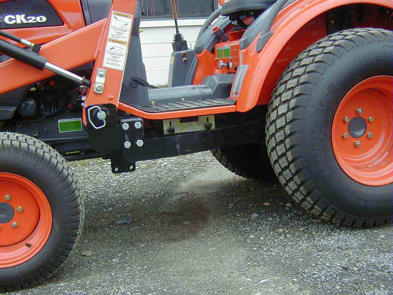

I believe you'd have to go with the Woods Loader in order to use the 4pt hookup, at least it looked that way on the CK20 my dealer had set up with Woods. As far as I'm concerned, that set up is tops. There was no looseness at all, no wobble like on my Kioti backhoe. I think the Kioti is slightly easier to take on/off, but not that much, you pull two pins and disconnect the hoses. On the Woods, you take off two bolts, lift it off the bottom hooks and disconnect the hoses. Not much more work, but a little.
The Kioti subframe mounts tend to loosed up with use unless you weld the bolts solid. Not a big deal, but the Woods is def. better in my opinion.

Yep, the Woods hoe will fit with the Kioti loader. He said it dosnt matter whats up front. I believe its indepentant of the loader. Dealer said I could still get that brush mower later for that price so maybe later this summer. Ill stay away from the rough stuff for now.

Maybe you can see in this picture why I thought it had to be hooked up to a Woods loader. It just seems as though they're made to go together. The Kioti BH bracket that goes on the loader hangs much further down and the subframe attaches there. That's why I wasn't sure you do it. I'm glad you can do it with anything. John
