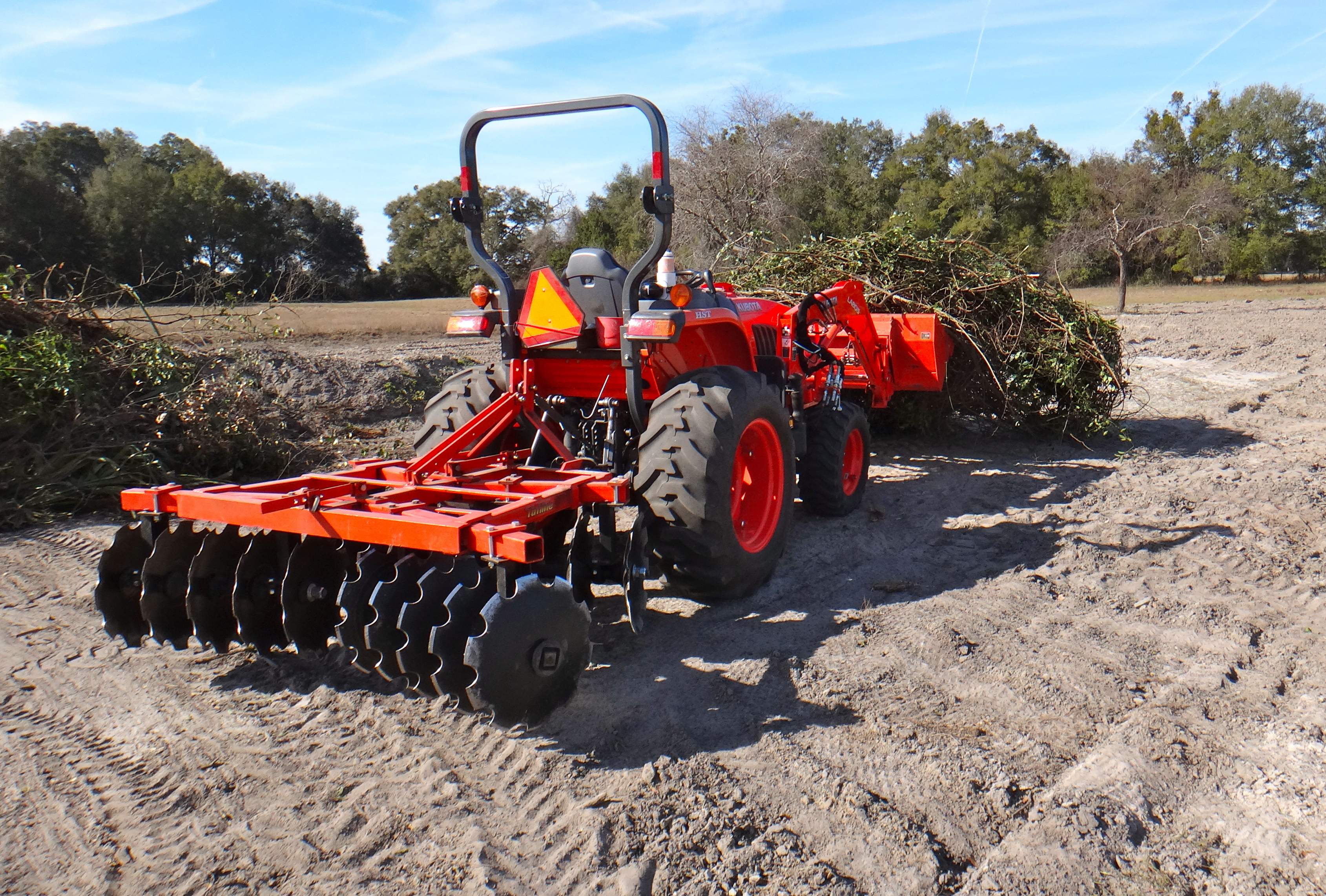

Is your Long 2460 2-WD or 4-WD?
Tractordata.com shows Long 2460 weight at 4,220 pounds.
TractorData.com Long 2460 tractor information
Certainly tractor weight is as important as tractor engine horsepower in the tractor's ability to do work.
If your Long 4520 has 4-WD why not start with 4,220 pounds as a reference and shop from there? Obviously, FEL will add weight to the new tractor.
If your Long 4520 has only 2-WD you will find a newer 4,220 pound tractor with 4-WD much more capable. Tractor design has progressed like (most) other things.
Buy for your five acres; 45-hp with 4-WD is ample, ample. You can pull a HEAVY Disc Harrow with a 4-WD, 45-hp tractor weighing 4,220 pounds, probably 8' wide.
I could change my search to include 60-80 hp tractors, but I'm afraid that something that size might be a hindrance working in the garden or in the woods, along with putting it on the trailer to carry somewhere if needed.
I always consider nemesis of soil compaction. I want enough tractor but not more weight than enough + 10%.
