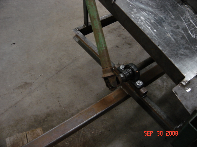

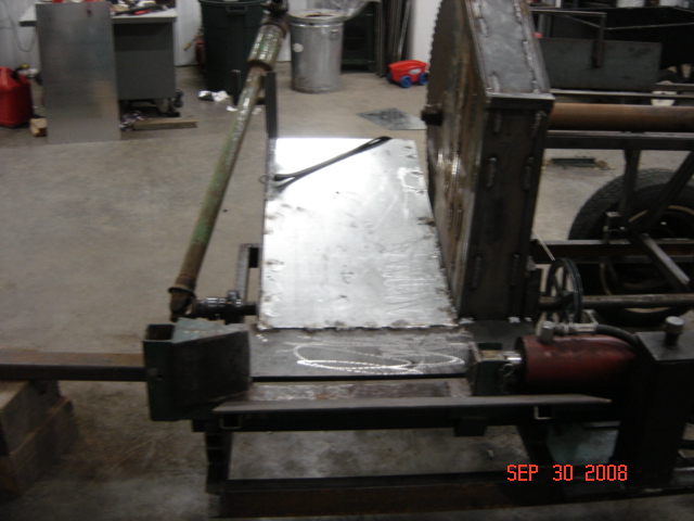

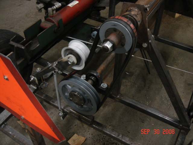

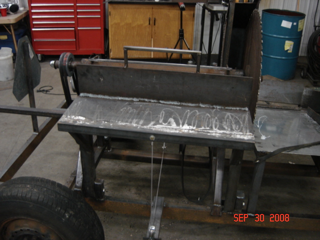

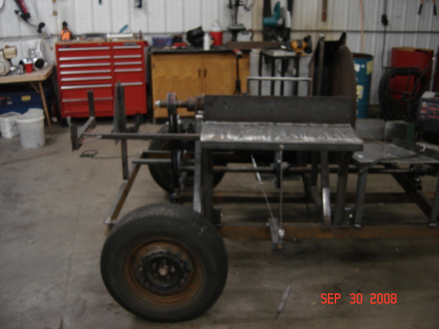

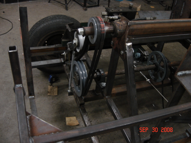

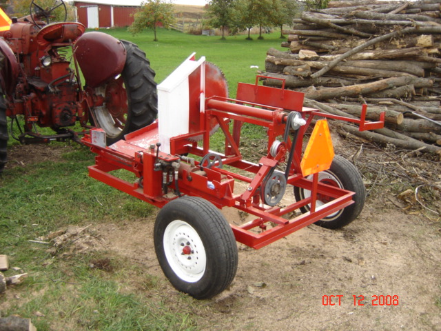

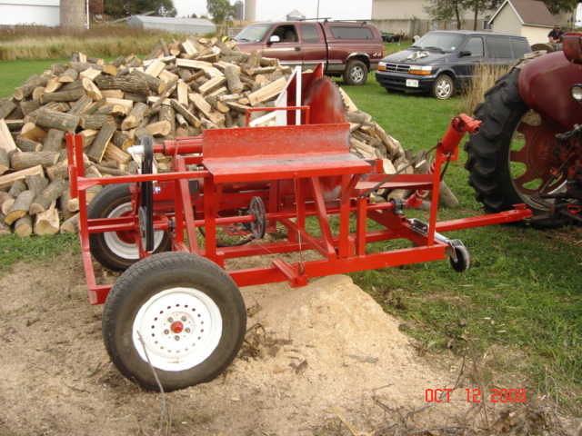

I just built a Buzz Saw- Wood Splitter combo rig. I had the arbor, blade and splitter but wanted something transportable and pto powered. Engine was bad on the splitter. Bought the structural steel locally and picked up the tires- rims and spindles from the boneyard.
Pics are before the painting. Tried it out and the saw works great. Hums right through 12 in oak and maple. Splitter runs too slow though. I might need a bigger pump.
I have about five hundred in the whole thing.

I see this is your first post, so let me be one of the first to say Welcome to TBN! Glad to have you aboard. Please update your profile to let us know where you are from.
Your new unit looks interesting. I often wondered how I could mate my buzz saw and splitter into one unit to make my wood cutting / splitting less time consuming. Couple of questions - once you've cut up some wood with the buzz saw, I'm guessing you simply push the blocks to the other end of the table, and then go around and split them up. Is that how you are using it? If that is so, are you concerned about that saw blade being so close to the blocks waiting to be split? Maybe it isn't a concern, but the picture makes it look like they are pretty close. I think I'd want to build a sheet metal guard that closes in the blade on the splitter side of the unit.
Don't let my comments or questions take anything away from your unit. You've given me a few things to think about regarding my own stuff. Thanks for sharing your project with us.

Corm - he's got a guard on it -- take a closer look
tj -- REALLY COOL! I WANT ONE WA-A-A..... I'd bet something like that manufactured would cost several thousand.
what about hooking the splitter up to your tractor hyd?

Thanks for all the advice. I will take pics this weekend of the project now that the painting is completed. I run this off of a Farmall B with no hydraulics.

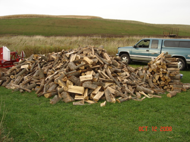

We had a very busy weekend. Got the Machine Painted, Fixed a hydraulic leak on the 450 and cut a good pile of wood.
