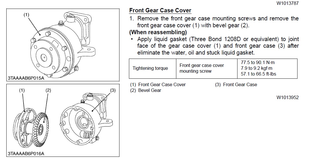

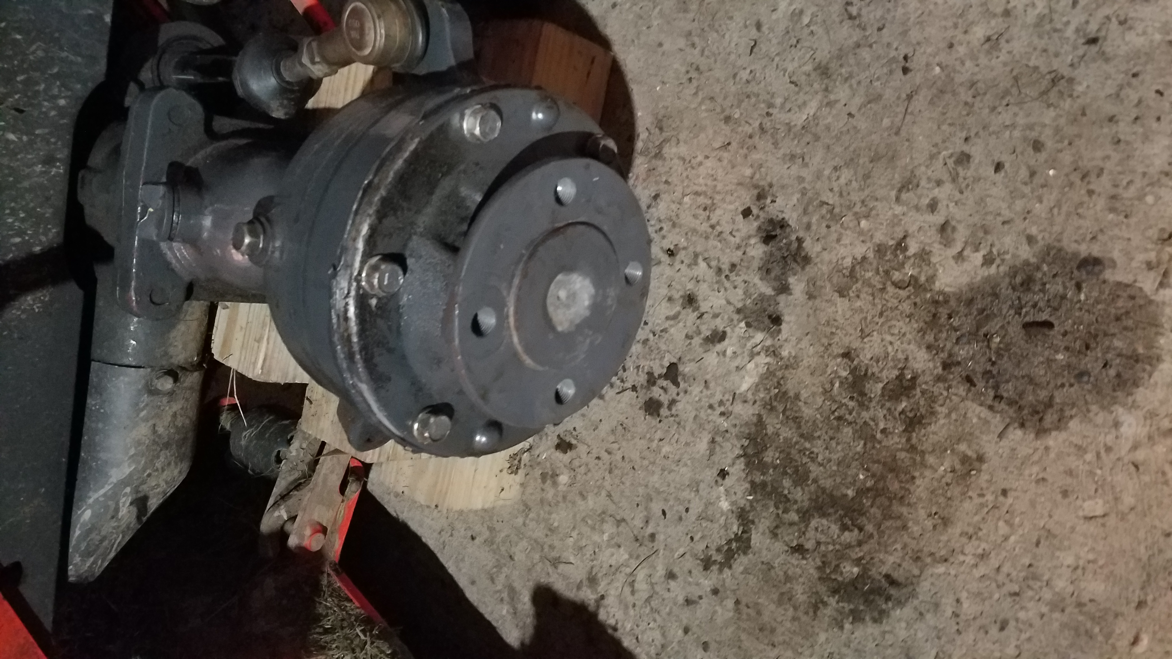

Does anyone know what these 6 bolts are supposed to be torqued to? Replaced the seal but don't want to over tourqe it.
   / BX 1800 front hub tourqe specs?
Thank you so much
