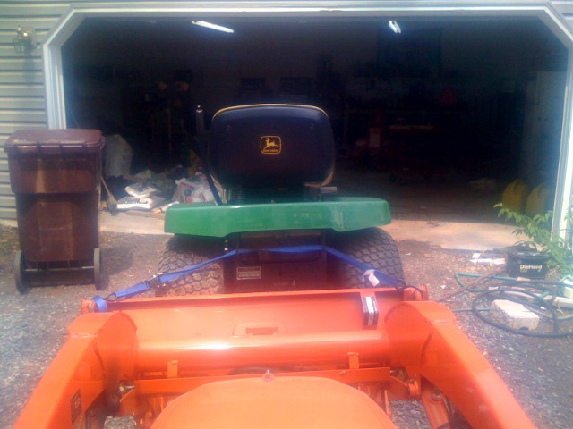

Sounds like you had a fun day. Here's what I toted around my property today with my BX.
   / BX-1850 and BX-24 instrumental in driveway gate installation.
Looks like you are dragging a JD around. Poor thing.
