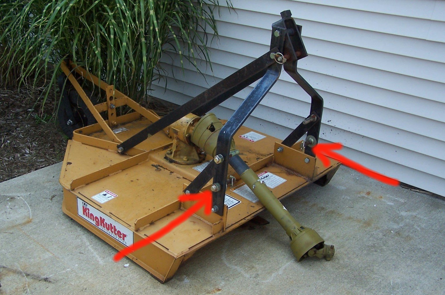

Jimmy,
I had the standard 4' yellow KK rough cutter on my BX2200. I had to drill two holes in the frame and installed two lower pins turned inwards. With this setup, it fit the BX very nicely and lifted quite high.
See attached photo.
