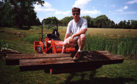

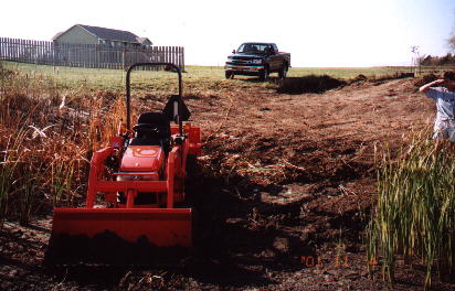

   / BX 2200 Any problems? #3
Sorry for a second post--in the old pic attached above notice the pond in the back ground and in this attached pic notice the stuck BX and all that "raw" ground in the pic. Much of that was excavated using the BX with the FEL and boxblade. Yes, the BX can dig large holes and do "real" work. Good luck. J
   / BX 2200 Any problems? #4
Oh, good grief, I apologise but it dumped my attachment so here it is Rodney. Sorry to other forum guys--don't bother to look, you seen it before. My apology. J
