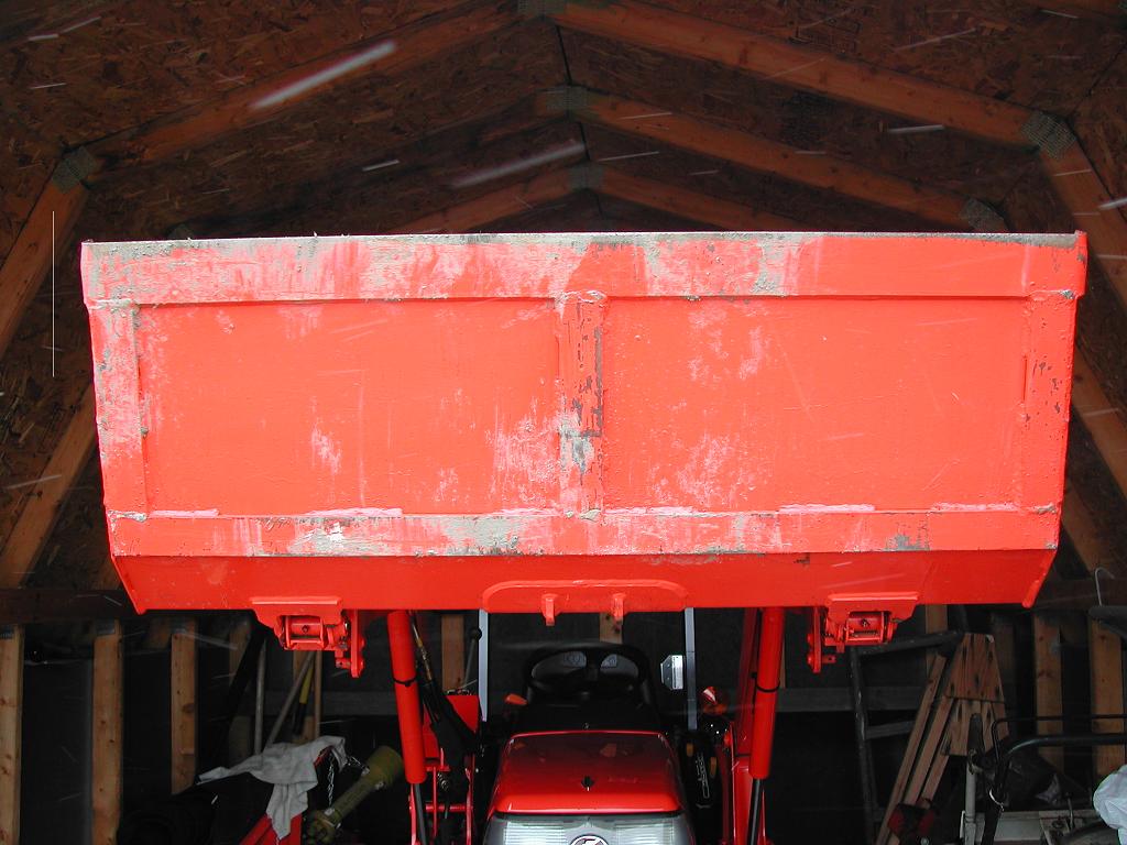

As for the FEL, you could just have the bucket rolled back too far. Raise up the bucket and look at the bottom...you'll notice that the sides of the bucket have a lip that extends down about a quarter inch, and they WILL dig into blacktop. Also notice that the front cutting edge doesn't have this. To stop making grooves in your blacktop, just do what I did: Tilt the bucket down enough that the back sides of the bucket are up about an inch, then let it float...the cutting edge will support the weight of the bucket, spreading the weight across the entire front of the bucket, with the back sides up just a bit, eliminating the scoring that you get if the edges are riding the blacktop. Been there, done that. I solved this completely by welding a skid plate along the bottom back edge of the bucket from one end to the other, the same thickness as the lip at the edges...now I can tilt the bucket back if need be to get the cutting edge up and still not mark my drive. Either way will keep you blacktop nice.

I agree with Charliebrn. I got myself some angle iron and bolted it onto the sides of the loader to make skid feet for where the sides of the bucket extend down. Works great, doesn't mar my blacktop and I've got a pretty good plowing machine with the loader.

Here's a pic of the wear plates I had put on my BX.....

I'll see if I can't borrow a camera and take a picture, so I probably will not be able to do a picture post until the end of the week. I just went out and bought some 2" angle iron. I attach it with two drilled holes through the side of the bucket. The angle iron curves under the bucket and provides a nice level surface for the sides of the loader that extend down. I plow my blacktop with nary a scratch. I take them off for summer time mulch and dirt moving.
