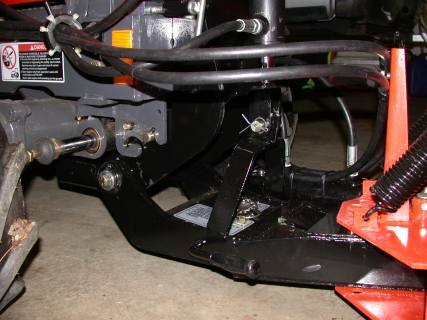

Does any one have any pics of how the front blade hooks up on the BX. I have a Blade for a John deere and was thinking of modifying it to fit my BX. It has a hyd. lift cylinder but is manual swivel. I was thinking of making a mounting bracket likes on the john deere lawn and garden tractor and bolting it to the front of the BX frame where the brush gard bolts on. But dont know if thats a good place or not, could i damage the frame pushing snow from there?

it mounts to the same quick hitch used for the snowblower, sweeper, etc.
   / BX 2200 front blade #4
Buckcreek, I will post some pictures, I hope they help you out.
HarleyScooter

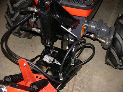

   / BX 2200 front blade #5
another

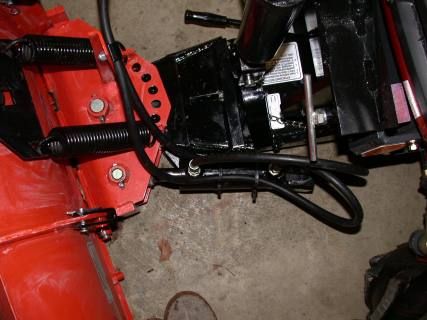

   / BX 2200 front blade #6
one more

Harleyscooter, Does the front of the frame take all the pressure when pushing with the blade, Thats what i was concerned about. I didnt know if it has some kind of subframe or not. I know on the 317 john deere its originally off of it just hooks up to the front of the frame, so thats how i was going to make work but my Dad said i should be cautious because The BX is alot more powerful than his little JD.
   / BX 2200 front blade #9
Yes it just connects to the front, the sub frame connects with two pins to the bracket below the frame, and a pair of clamp blocks on top of the frame. The frame is solid up front. I can try to find the manuals that came with it, tomorrow and see if I can scan the assembly pictures if that would help you.
