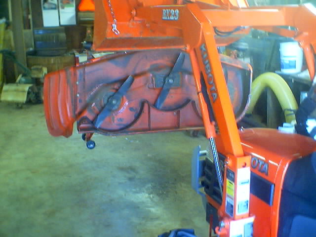

After useing my 60" MMM as a makeshift bushhog to take down an over grown 2 acres this past week, I just got done servicing my MMM also.
Like Charliebrn said, you probably started filling up the metal cup's that functions as both protector and grease holder for the blades.
Normally I don't pull the MMM just to grease it, as I grease it every 10 hrs of use. But atleast once during the mowing season and when I put it up for the winter I drop it and give it a good servicing. I have a set of mower axles which makes servicing of the MMM very easy.
While I have the blades off for sharpening (I use a file btw), I'll also take the cups off so I can see how much grease it takes before it starts to squeeze out of the spindles. I have an air powered grease gun and the 1st time I ever greased the MMM it took about a tube and a half. I believe that the MMM wasn't properly greased when I took delivery of it.
Now that I keep it regularly greased it doesn't take but a couple squeezes to see it starting to squeeze out from around the bearings and I use this as a benchmark. It's good to get a benchmark when it's off because you can't tell when the spindles are full once the MMM is back on the tractor.
A good rule of thumb is that you can't over grease the MMM. So when in doubt about the hrs, give it a couple of squeezes for GP :D
I haven't filled the cups up yet but when it happens I'll be making the cleaning out of all the grease thats collected in the cups during the mowing season as part of the winterizing ritual.
Volfandt
