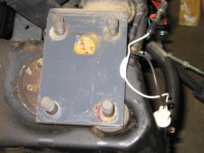

TractorSmart sent me a free schematic for my BX2200 so give them a try. I had two problems. The first was the fuel sender unit would short out when I filled the tank so replaced it with the upgraded one. The second was a pinched taillight wire between the rollbar and the mounting bracket.
