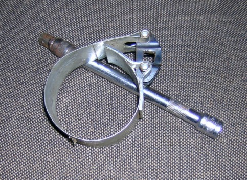

   / BX 23 FILTERS CROSS REFERENCE? #7
Escavader,
I use this type of filter wrench (see attached) with the extension bar and ratchet on my BX23. Works fine, you don't have to remove anything.
Ken_CT said:
Escavader,
MORNING KEN CT,
Where do I get one? Happy Holidays.
ALAN
   / BX 23 FILTERS CROSS REFERENCE? #9
escavader said:
MORNING KEN CT,
ALAN
I don't remember where I got that one, but they are pretty common. Probably Advanced Auto, NAPA, or maybe even Walmarts.

   / BX 23 FILTERS CROSS REFERENCE? #10
That is the type that I also use, but with the crocus cloth in addition.:D
