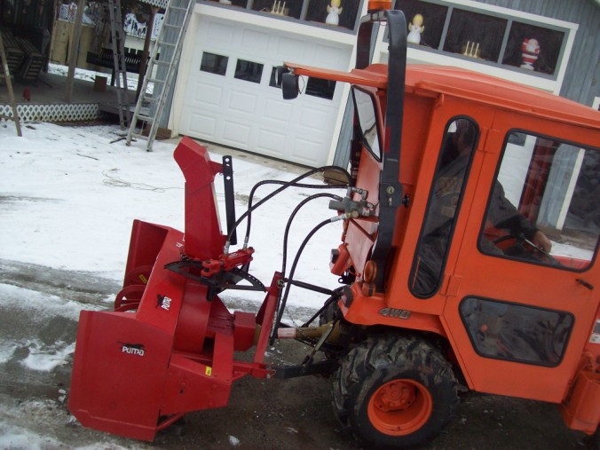

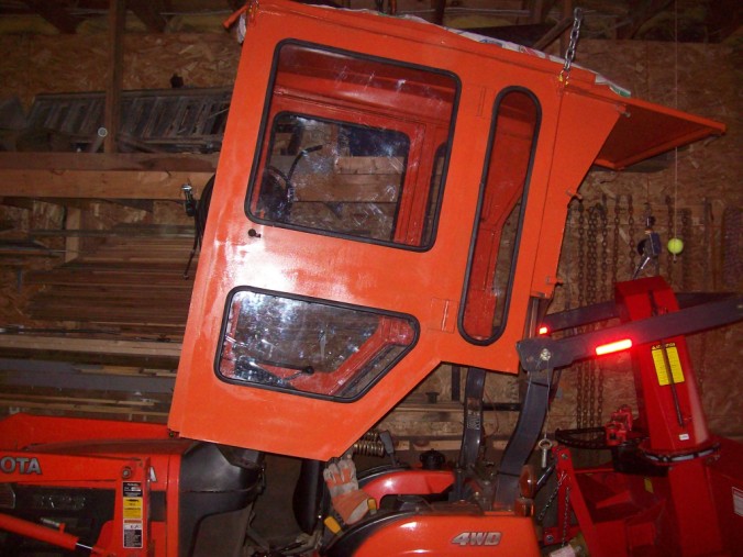

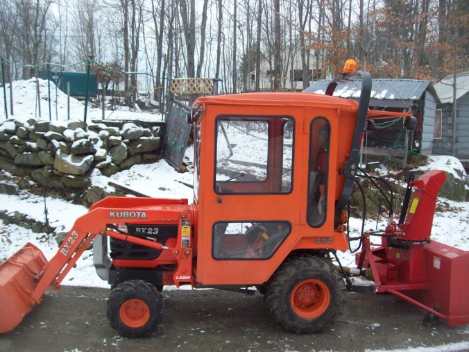

bx-23 ,
ITS FINALLY DONE:eek::eek::eek:

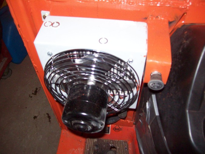

ITS quiet inside and nice and warm

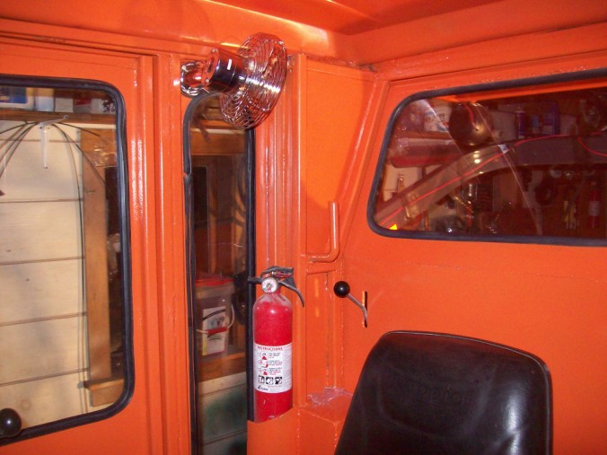

   / BX-23 HOMEMADE CAB PICS

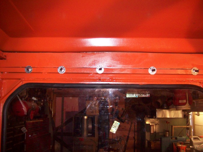

Ihave lighted toggles inside,12 volt outlet,hatand coat rack,glove clip.circulation fan ,hotwater heater two forward floods ,2 rear floods,revolving safety light ,small tool storage,chute control for blower,wired for wiper if i want one in the future,all wiring color coded and in the frame,grommets where it comes out,Itheavy duty dbl steel tubing would survive a roll over easy
Idid a rough tally,got about 800 bucks in it:)not counting the heavy alternator i just installed

   / BX-23 HOMEMADE CAB PICS #6
That is awesome for the price.

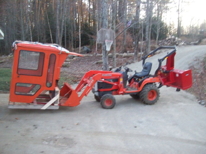

The cab really doesnt weigh alot ,If it did my little bx couldnt lift it.

Where did you plumb the heater in?? Do you have pics??
in the by pass lines.15 minutes in there and your shutting it off:)
