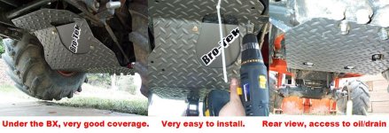

Hi jnb,
Get a new filters & put it on, if it still "wobbles" then new parts will need to be ordered.
Send me an email at Bro-tek@hotmail.com , so I can send you info on a skid plate, you should not have to go throught this again.
Bird

Having the skid plate gives me peace of mind in the woods.
   / BX-23 !@!$%@% hydraulic filter location! #4
Here a first look at the new and improve version, for the MMM.
