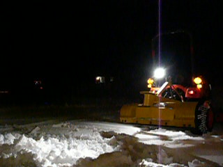

I have a 5 foot Walco blade on my BX. It's a cat 1 but works fine on my machine. Excellent for snow removal.

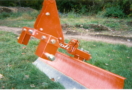

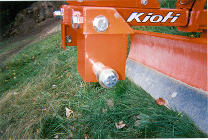

I bought a Kioti RB22-60 rear blade for my BX23 and it has worked out great. I looked at a few of the others available out there and went with the Kioti because it was only Midwest manufactured blade I could get in orange to match the tractor. The Midwest/Kioti/Corriher RB22-60 blade are all the same thing - all manufactured by Midwest. I liked the tilt/swivel/offset features and it was the heaviest blade of all the ones I looked at too. The only drawback was that I had to make some custom extensions to lower the mount points so the blade would lift high enough on the BX 3pt. With the extensions it lifts more than high enough and works great on the BX. I got mine at Ken's Tractor and truck up in Keene NH. Picture is attached of the extensions

another shot of the extensions
