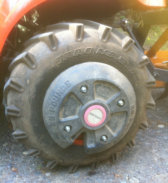

Do they make wheel weights for the 24 ? Or weights for the side of the tractor ?
   / BX 24 Stability #8
Wheel weights:
http://www.tractorbynet.com/forums/attachments/253170-my-bx-wants-hide.html
Here's the photo.
Bruce
   / BX 24 Stability #9
The cab must raise the center of gravity and add to the tippyness. Fluid in tires + weights will help, but I would also look to put something heavy on the 3 point... box blade, ballast box, etc. Then you'd want to add some front weights so it isn't back-heavy. Pretty soon you'll be all set for the tractor pull at the county fair.
