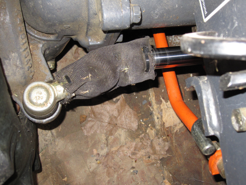

Has anyone else experienced ripped tie rod boots on their BX 25?
This will be the 3rd time replacing mine since I bought it. I have less than 70 hours on it.
They seem to be ripping right where the large clamp band is at. Both sides are doing this.
They are not being caught on anything while in use.
Also, you can't notice until you turn steering to either side. Thanks for any input.

yup. mine were replaced once about a year (~150 hrs) into ownership. the dealer noticed one was torn when i brought the machine in for a warranty replacement of the boot at the front end of the main driveshaft (that runs the length of the tractor) opposite the HST fan. you might check yours, especially if you are under warranty - it is very labor-intensive to replace it.
i am certain that neither of these were damaged from use or snags, but rather were a result of poor quality from new. my machine is used 99% for finish mowing. i don't own any woods, unkept areas or a brushcutter. i wrote to kubota on this point but did not receive any response.

I'd would just get a bicycle tube and cut it to fit over the tie rod and ziptie it in place. cheaper then messing with replacing boot that has no recall or thicker boots for.
   / BX 25 tie rod boots #6
I went through several tie-rod ends due to ripped boots. The solution I used is to cover the boots. I bought woven cloth cover made for hydraulic hose. Went to a local Parker Store and got a size that fit over the boots. I pierced a few holes with a soldering iron for lacing a tie wrap through, and tie-wrapped both ends on to the metal on each end. Only cost a few bucks and I have not had any boot problem since deploying the covers.
