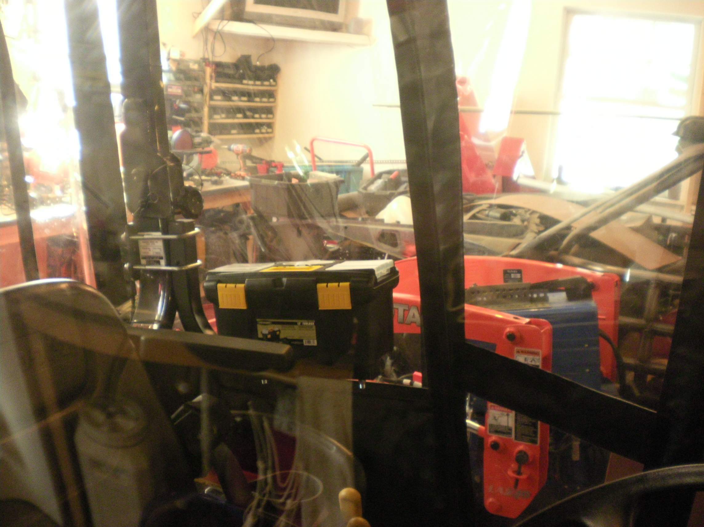

I took the idea for a tool box from the bx25d, got a inexpensive 12" tool box and fabricated up a clamp on mount and there we are.
not in the way as far as I can see and holds a lot of the small tools and parts.

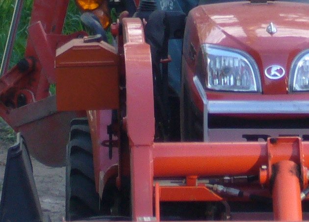

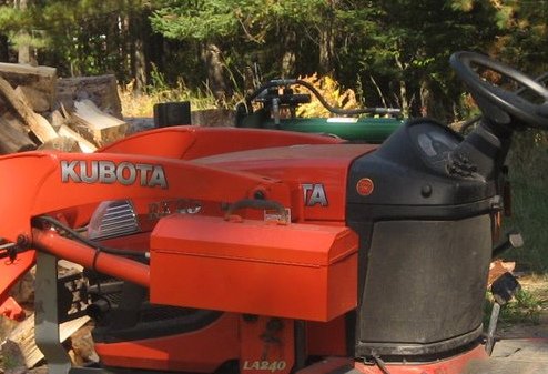

Your setup looks nice.
I bolted a couple of steel tool boxes on teh FEL supports. Works great, very solid.

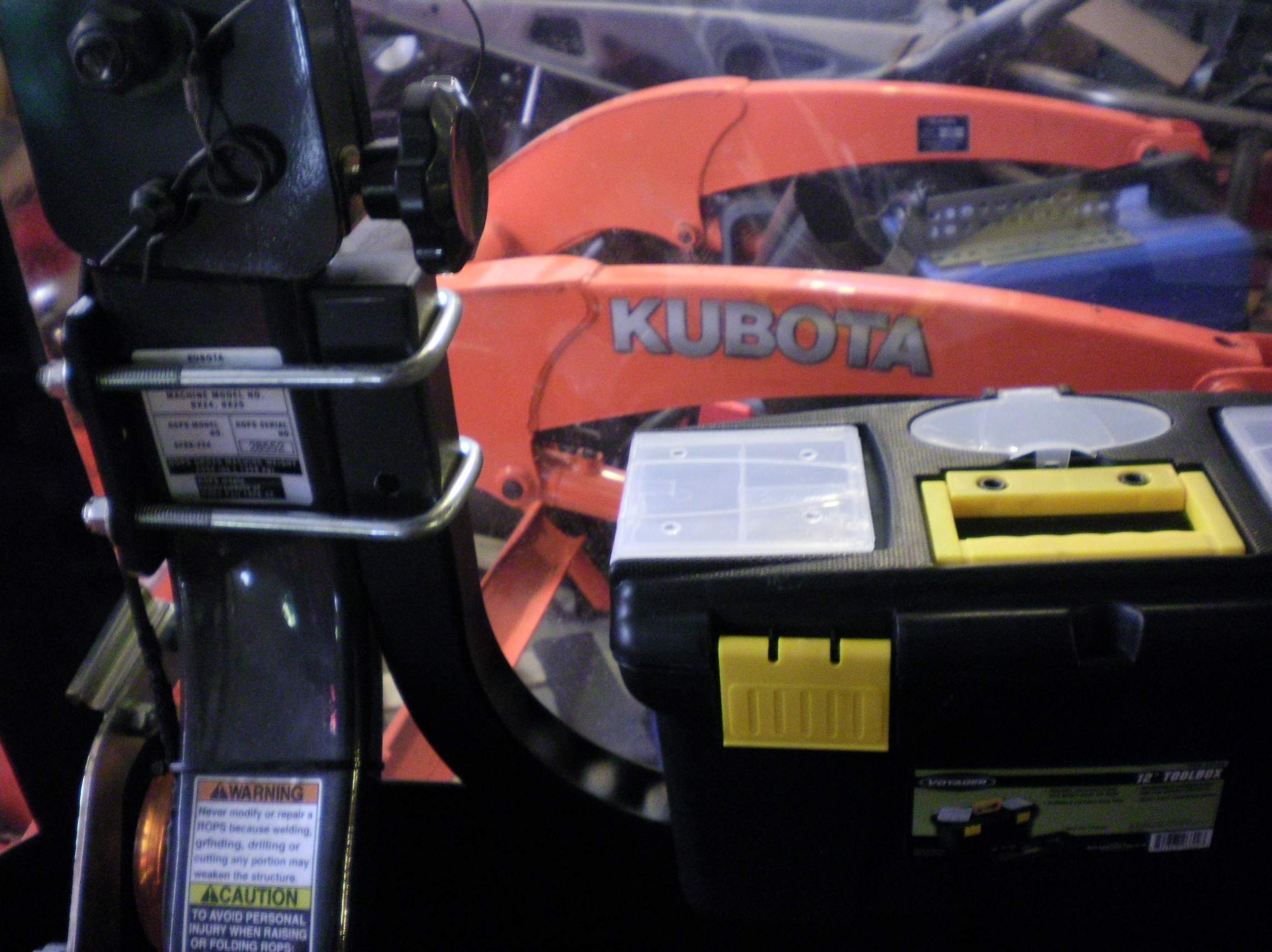

Great idea. If I might ask, where did you get the square u-bolts? Thanks.
   / BX 25 tool box #4
I have seen square u bolts at TSC and lowes.
   / BX 25 tool box #5
Yeah, a number of places carry square u-bolts but not nice fitting ones for the ROPS. I have found good ones to go the other way like this -
but not nice fitting ones like those the OP used. They would be something like 3/8 x 1 1/2 x 5 or maybe 3/8 x 1 3/4 x 5. Just trying to find his source.
Dean
   / BX 25 tool box
the ubolts came from a canopy manufacter, that were given to me.
   / BX 25 tool box
look at a triler supply company they use some like that to hold the axel to the springs
   / BX 25 tool box #9
I use threaded rod (3/8 or 1/2 inch) to make any size needed. Use a torch to heat then bend over a simillar size tubing or in a vise.
