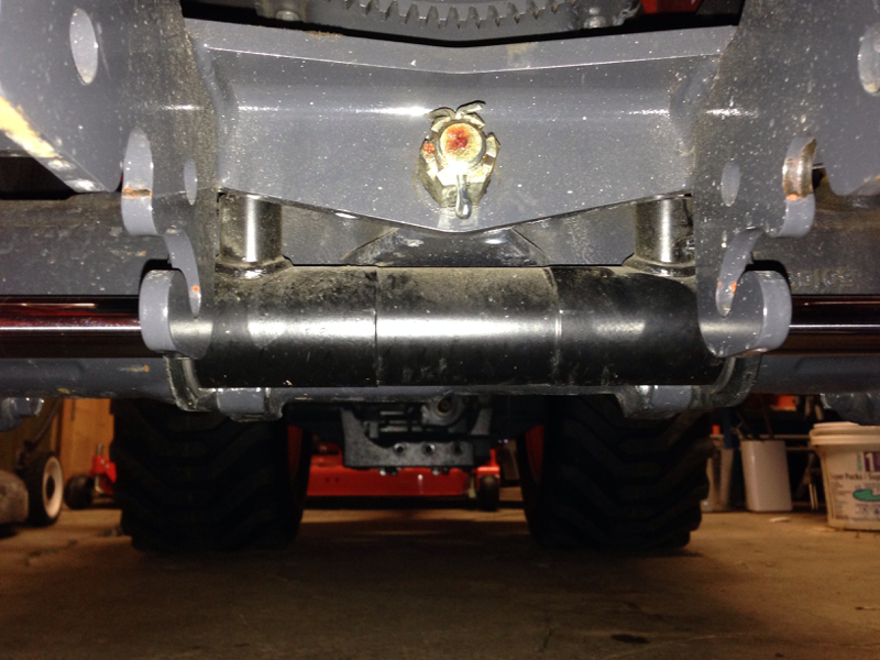

Hello, i just rolled over 10hrs on my new bx25d-1. So far, i have loved every minute on this thing .
However, last night I was doing some light loader work and noticed a clunk periodically. After investigating, it was easy to see that there was some lateral slop on the power steering cylinder. It looks to me that the whole power steering housing moves side to side about ~40 thou.
It looks to me that the only thing preventing lateral movement of the power steering housing are two snap rings, which leads me to believe that this play that has presented itself must be common, as this setup seems a tad weak.
Has anyone experienced this same issue? It drives me nuts.

#9

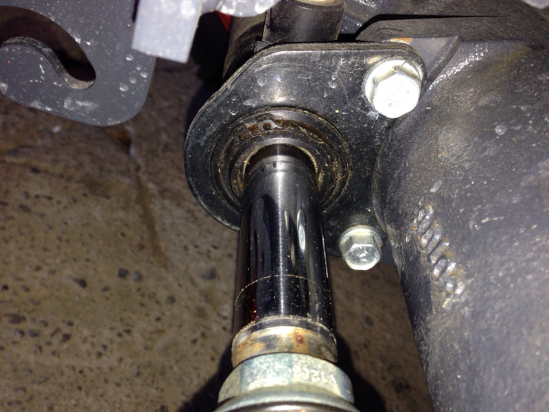

Here are the photos of the housing. I couldnt attach the video i sent to the dealer
   / Bx-25d-1 - clunk / free slop in steering #10
Are you saying that the second pic, which shows the two bolts holding the bracket to the axle tube is where the movement occurs? That between the left side bolted bracket and the right side same bracket the black tube, which retains the steering rod with the circlip moves between the two end brackets when turned lock to lock?
If so, how much movement are you describing? Does it only occur when you go to lock on either side of the mechanism? What are the two, what look like tubes, which go vertical in pic one? Are they part of the steering rod housing, and if so, what purpose do they serve?
