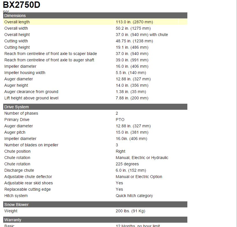

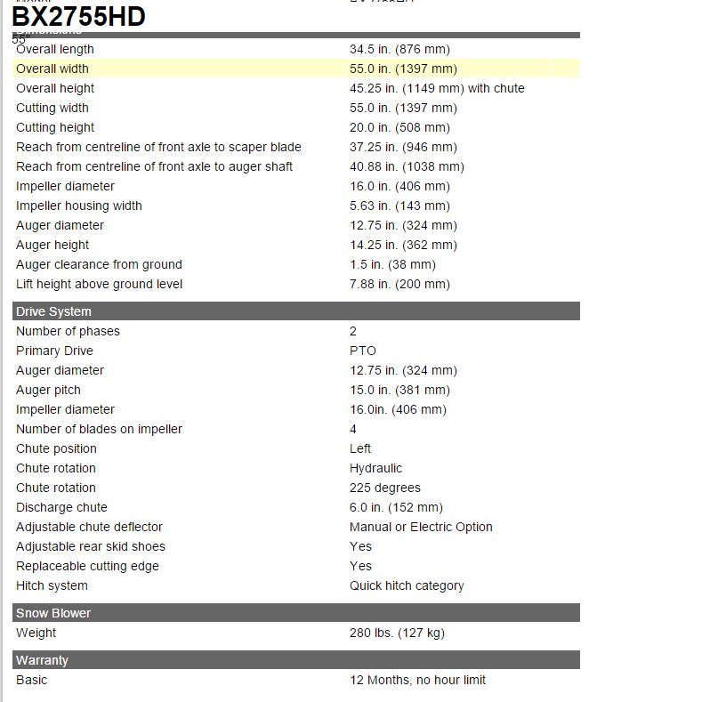

Anyone know, besides the 5 extra inches, whats the difference between the 5450 and the 5455?
What else am I getting for the extra $600?

Specs for the BX series snowblowers.

I see an 80 lb weight difference, but the impeller diameter and depth are about the same, so I would expect that the amount of snow they can move is about the same.

The 55" HD model comes with hydraulic rotation standard, it is an ~$800 dollar option on the 50", so the difference between the two is really ~$600.

4 -blade impeller in the 55 vs. 3 on the 50 should throw snow well.
