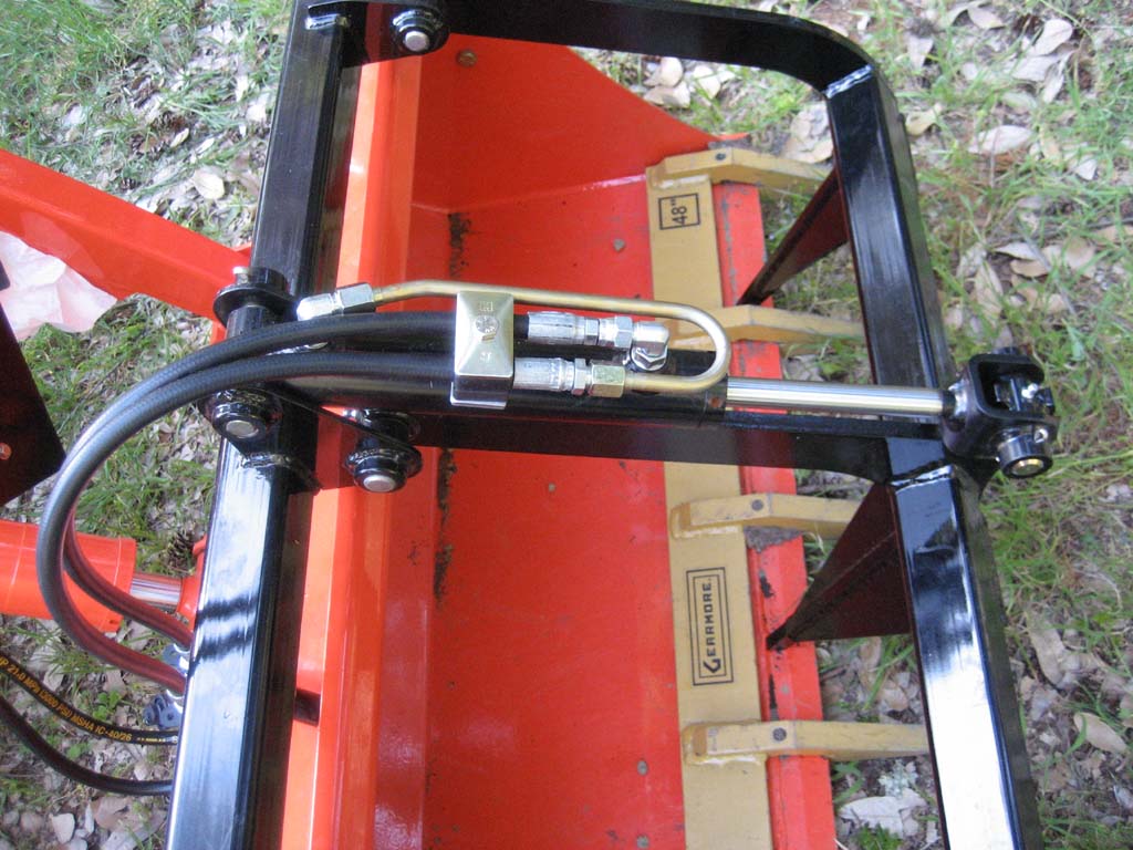

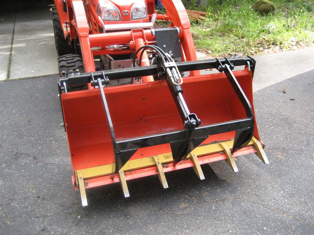

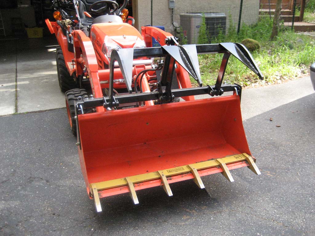

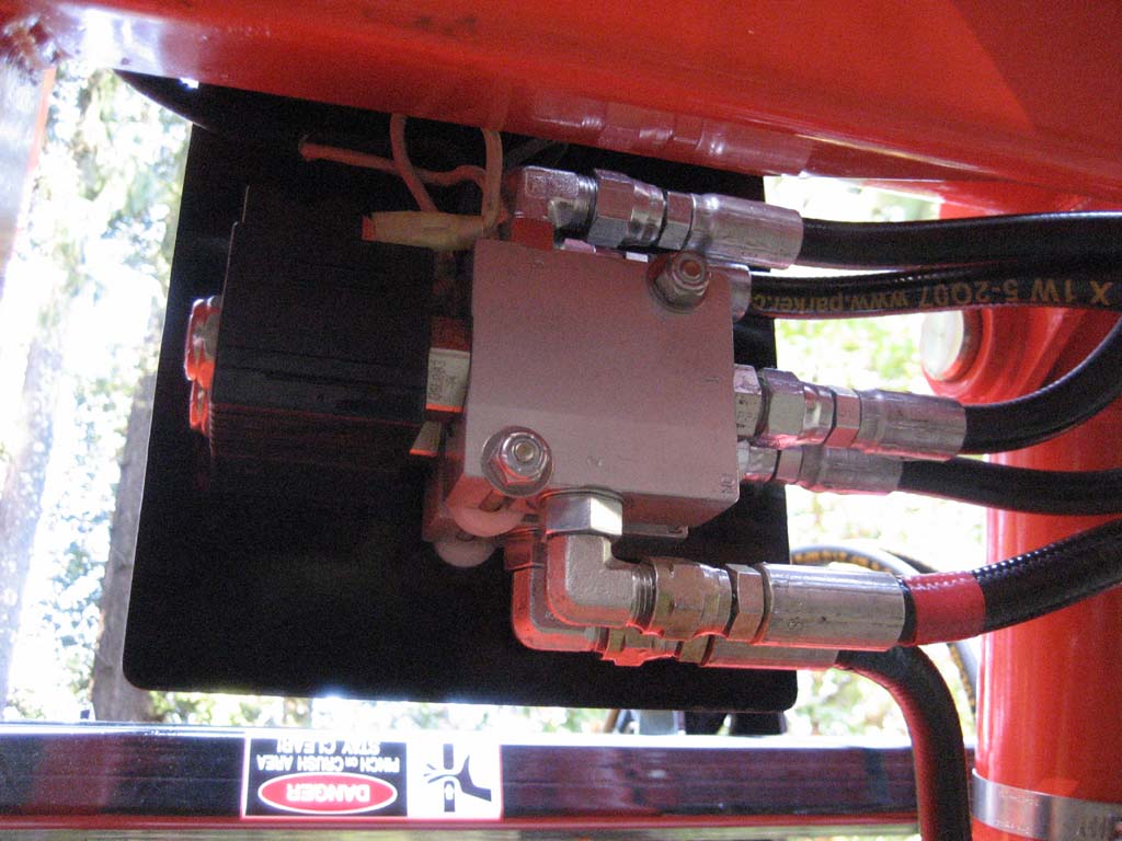

   / BX American Solutions Grapple #4
I got one of these from Jeff and have found it probably my most used attachment. Install is pretty simple and instructions are very clear.
I've used it moving brush for chipping, moving rocks for building a retaining wall, moving logs and rounds for splitting, and more. I have left it on for loader work and found it didn't get in the way much at all.
It comes off and goes on in less than a minute or two anyway, so deciding whether to leave it off or on is often just a function of what I think I'll be doing in the next half hour or so.
I give this attachment two thumbs-up, especially when you consider the very reasonable price.
Here a bunch of pics of the diverter valve plumbing, the mounting plates, and the grapple installed (open and closed) as well as a couple of "action" shots.

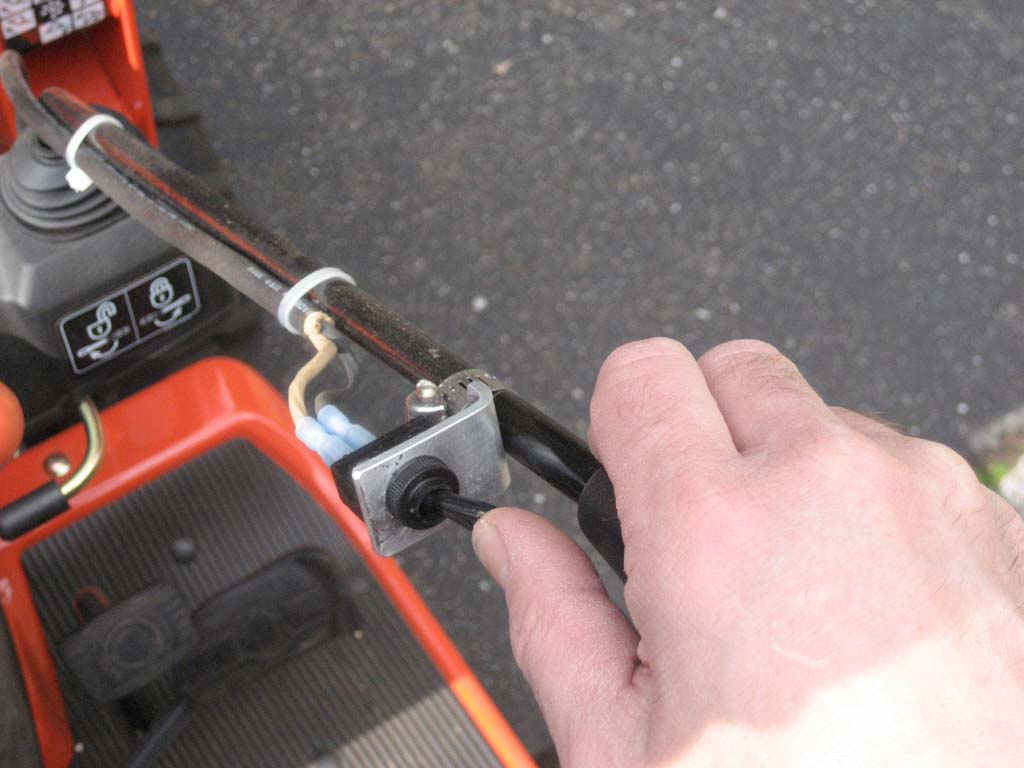

   / BX American Solutions Grapple #5
There are a pictures and a re-creation of the install thread I did here on TBN over at the
BX wiki
(check the navigation at the left)
Jeff is hard to get ahold of but worth it and he is a very nice guy.
Feel free to ask me anything.
mpowrd:
I see you went with the switch on the loader handle also.
I had to put a little penetrating fluid in the switch to keep it working. But that's after about 3 years of use. Not bad for a cheap bat handle switch that's not outdoor rated.
   / BX American Solutions Grapple #6
I agree that the installation is designed exactly for the BX and was pretty straightfoward. The only difference in my installation was that , I too, was looking for a switch or a new loader handle with a switch built in. I did not find exactly what I wanted , so I used the switch supplied with the grapple and took an idea from another TBN'er. I did not want to drill a hole in my dash and ended up putting it in the floorboard on the left side near the brake hold. It is out of the way and leaves my hand for the steering wheel while I use my left foor to depress.
