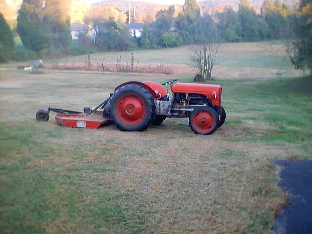

The attached pic is of a 5' Howse bush hog mounted on a TE20. The TE's PTO hp was rated anywhere from 18 to 20hp and as you can see it probably weighed in at nearly 2k lbs.
Working that 5' BH was pretty hard on it and when I raised it up it could cause he frontend to come up ever so slightly when I hit bumps or was going up hill. I'd say a 5' BH would be a tall order for a BX to handle. I'd definitely try before I'd buy...
