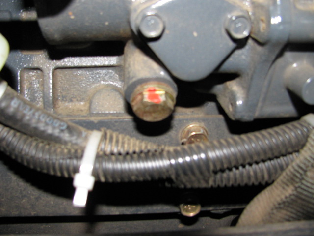

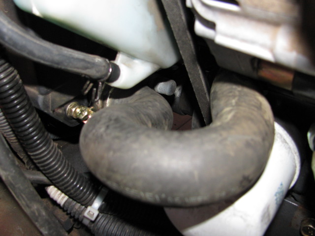

The 1st picture shows the lower hose and just beyond it the drain plug that seems to correspond with the drawing in the user manual. In the second picture on the other side of the engine, is the bolt marked red the block drain plug? Nothing about it in the user manual that I found. Does the water temperature need to be hot to open the thermostat when draining?

I drained mine when it was warm but not hot. Be very carful because you can get a nasty steam burn if you open it up when it's hot. I disconnected the lower hose and removed the bolt in your second picture. It seamed to drain the entire system. I refilled it with distilled water, ran the engine up to operating temp, let it cool for about 30 min, drained again and then refilled with Fleetcharge 50/50 mix from NAPA.
I don't know if the Kubota requires the anti-cavitation additive or not but the Fleetcharge has it.
