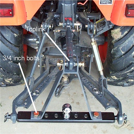

Can someone post some pics of how they installed the draw bar on a BX. I picked one up at TSC and I'm not sure of the part to buy to keep is stationary.

By stationary, do you mean so that it does not rotate? My tractor dealer fabbed up this little device that slides over one end to keep the drawbar facing up, I will grab a photo if I can tonight for you.

Weld (or ask someone to) a small piece of angle or flat bar on top of the drawbar at one side. Do the same on the bottom of the drawbar on the other side. This will keep it from spinnning.
/ BX Drawbar #11
Here is the one that I made. It works OK for my needs but it does have a design flaw. If you turn too sharp the tongue can hit the support frame.:mad:

This is what I did to keep mine from rotating. I think I posted it once before. Works good (and cheap).

Bigdad,
Your's looks the easier way to go. Nice and simple.......
