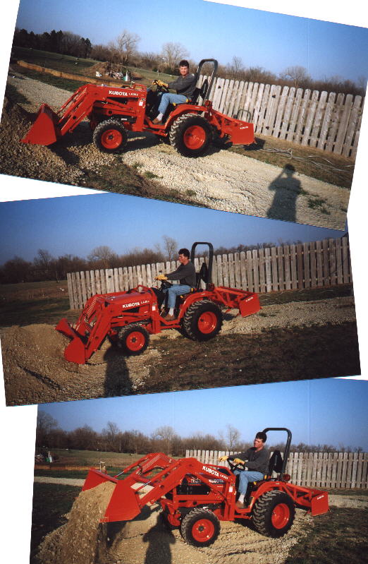

Okay, the digging thing, it takes practice, the bucket full thing, that takes practice too, the GT on steroids--whatever. Here is a hint, get a truck load of top soil or mulch deleived to practice (play) with, it will be a big help and useful too in learning how to operate. Tilt the bucket slightly below level, push into the dirt pile in 4WD Low range and as the bucket pushes in begin rolling back on the bucket and begin raising the FEL. Go into the dirt pile low. When you have dug out quite a hole drive up to the dirt pile and raise the loader high and drop the bucket full tilt down and then lower the bucket into and as far behind the pile as possible so as to drag the top of the pile off and into the emptied out hole--then using the first technique go at the pile again--probably does not make sense till you actually do it.

Sorry for the second post but I got an action sequence here that shows the procedure for attacking a dirt/gravel pile. Notice in the top pic the bucket is level or slightly down and low, in the second pic notice the bucket is being curled back as I drive into the pile and in the third pic notice the FEL has been raised pulling the bucket free of the pile. In this case I am not going to carry the gravel away but I am just spreading it out so I tip the bucket as I raised it to spill the gravel as I continue forward. This is the 2410, the BX is just as feisty, go have some fun. GT on steroids, sheeeesh. /w3tcompact/icons/wink.gif . The road in the picture behind the 2410 was built mostly with the BX. That gray loop of outdoor 12 guage wire in the background--that came from Home Depot. /w3tcompact/icons/smile.gif . J
